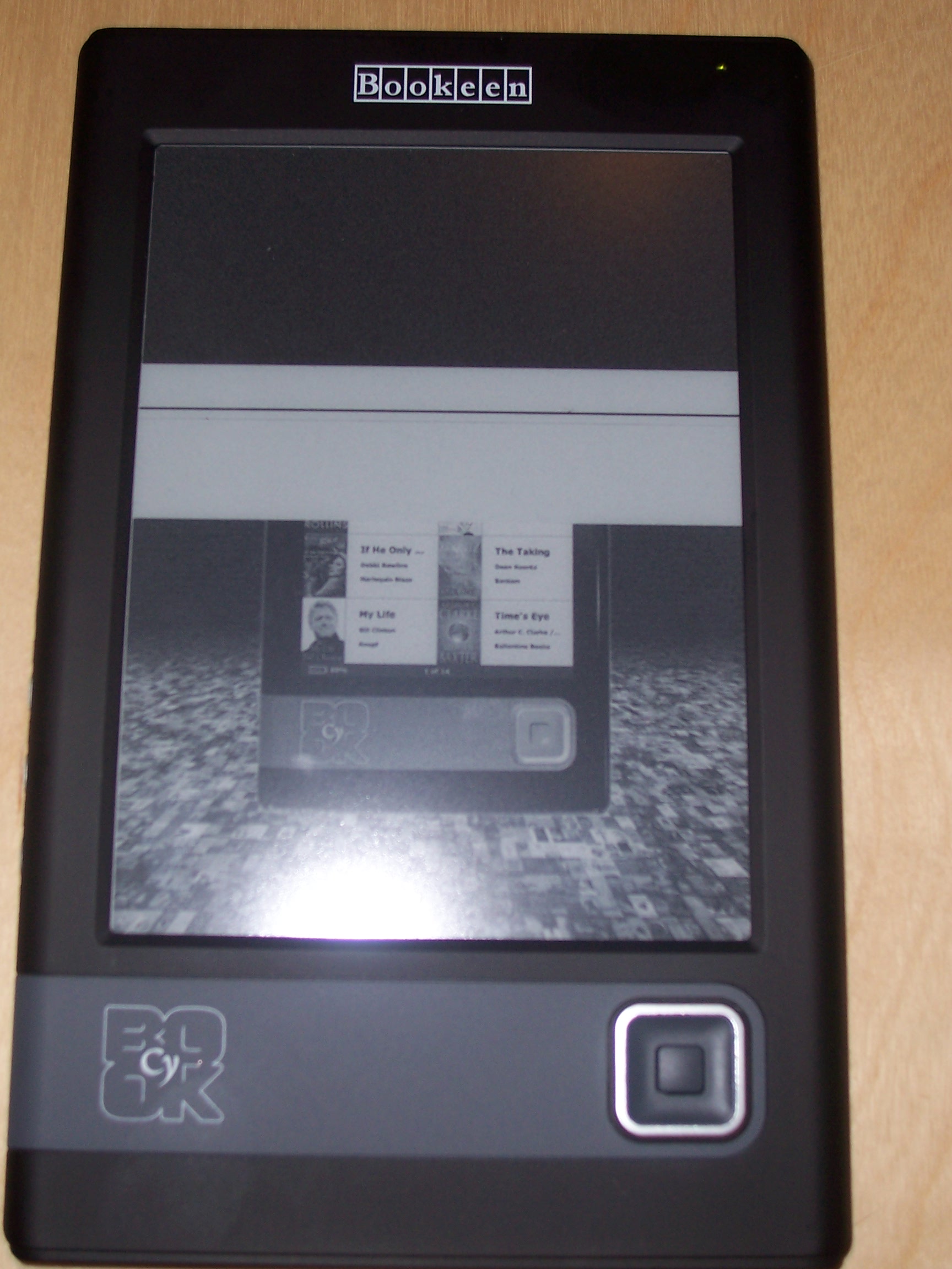

Hi,
This time I am done playing with my cybook, half of the screen went black. I tried to restart and reset but nothing improve. It's even worse since I took the picture, now the complete uper half is black.
I sent an email to booken, I hope I will get a replacement. I never drop it or anything. I read somewhere that this is not the first case like it, any feedback? Did you have it replaced?

It looks like the controller chip for the screen malfunctioned. You'll have to send the device in to be repaired or replaced.

I agree with Nate - that definitely looks like a screen controller problem. As Nate says, you'll need to send it back for repair.

I had a similar experience but the top half was all black ~ it was a return & replacement under warranty job ..

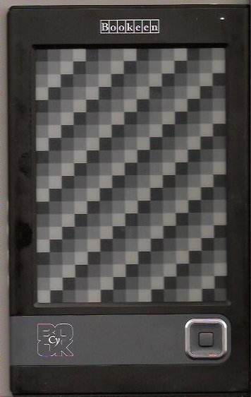

I think I have a similar problem. An hour ago, I disconnected my Cybook from my computer and went to power it down - bad surprise, the display was just a series of black and white squares! See the scan below...
So I tried reset and restart, but nothing works. After rebooting, the display
goes back to the squares again.
Anybody experienced something like this here?
Actually...yes. The exact same thing happened when I renamed the 'icudt36l.dat' file in de 'system' directory on the internal flash (don't ask. Insatiably curious :-)). You might want to see whether your internal flash is still readable and/or run fsck (Linux) or it's Windows equivalent (ScanDisk/chkdsk) on it.
Regards,
Marco.

Device: Bookeen Cybook Gen3 & Opus
OK, I guess the problem comes from my tinkering with the ebook files in the file manager while the Cybook was plugged in the computer. But I never touched the system files.
New problem, now: I checked, and I can't read the internal flash drive on the computer anymore. The drive is detected but can't be mounted in Linux.
