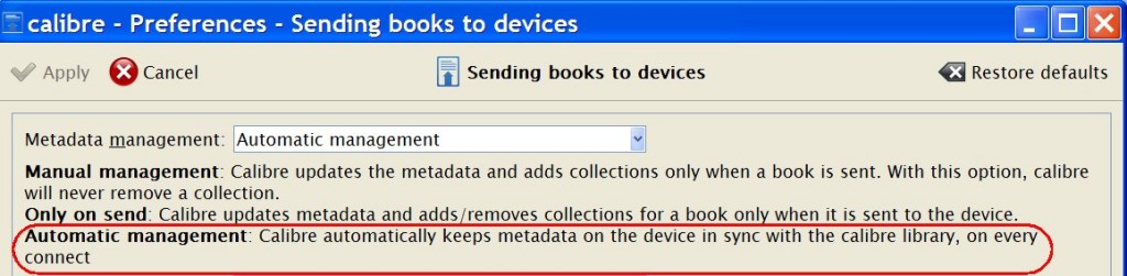

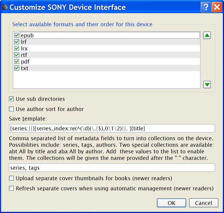

Old 01-26-2011, 07:05 AM   #4
DoctorOhh
US Navy, Retired
DoctorOhh's Avatar
Posts: 9,897
Karma: 13806776
Location: North Carolina
Welcome to Mobileread.
Originally Posted by durtreg View Post
Over time the data in calibre starts to differ more and more from the data on the device. Double books show up even though there are no doubles on the device (I searched). Titles/authors start to differ.
How do you get books from calibre to your device?
2) Keep metadata and opf/calibre data in sync
The FAQ says, that calibre can write metadata to pdf. Unfortunately it doesn't write the metadata into the pdf. Neither in Linux nor in Windows am I able to force my carefully edited Titles/Authors from calibre into the pdf.
First, I believe some types of PDF files don't seem to accept changes using calibre's metadata writer. However most PDF files can be updated. Do you have the pdf metadata writer plugin enabled?
=> is there an option which does: "write all metadata of the selected books as they are in calibre into the pdf/epub"?
Update: I see you already answered this question.
Yes. Do you only use calibre to manage your books on your device? Do you have metadata management set to Automatic management (see attached). Also if you set this to automatic examine the Sony Device interface plugin to see what you can customize (see attached).
ID:	65516   Click image for larger version

Old 01-26-2011, 09:07 AM   #6
jackie_w
Posts: 6,272
Karma: 16544702
Sony readers are not quite the same as other readers. All the metadata for your books (authors, title etc) is stored in a database file on the reader (FYI it's called media.xml). It doesn't much care what filename you gave your books in the Send-to-device template but it does store the filename in the database.
If you want to make sure that this database always reflects what you currently have in Calibre (without any need to resend to device) then the way forward is a Metadata Plugboard for the Sony. Every time you connect, Calibre updates the Sony database with the latest metadata no matter which book format (epub, pdf, rtf, txt). I don't use Notes and bookmarks much, but as far as I can tell they don't get deleted if you're using a Plugboard.
If you would like some help setting one up I'm volunteering to help. Just let me know.
P.S. You can also maintain Sony Collections with Calibre. This is entirely separate from the Plugboard.
P.P.S You can also maintain Sony thumbnails with Calibre. This is entirely separate from the Plugboard and Collections.

I am now convinced that the behaviour I see is a result of the above mentioned Sony-XML-Metadata getting out of sync with calibre. It would explain other things like disappearing books on the device.
Several things come to mind here: If you have automatic metadata management turned on, Calibre will change the collections if you edit certain metadata fields. This might make books disappear from one collection, thus seemingly getting lost. Another thing is that, if you have two independent Calibre libraries set up on your home computer and your work computer (by independent I mean not synced by, say, Dropbox or something similar) then the internal book IDs may differ in between the libraries. I don't know how Calibre determines which book is which, but I have a feeling that the ID might be involved. Thus, the two installations would probably get confused about which book is which.

These are some instructions to get a basic Metadata Plugboard specifically for a Sony.
Goto Preferences - Metadata Plugboard
In 'Add new plugboard',
in the 'Format' box, select device_db from the menu.
In the 'Device' box select PRS505 from the menu (I know you have a PRS650 but PRS505 is used for all Sonys from PRS505 to-date).
Based on the fact that you have used {author_sort} rather than {authors} in your Save Template I'm assuming you'll want to do the same in the Plugboard so ...
Set up 3 Source template/Destination field entries:
  1. Source tmplt = {author_sort}
    Dest field = {authors}
  2. Source tmplt = {title}
    Dest field = {title}
  3. Source tmplt = {title}
    Dest field = {title_sort}
Click 'Save plugboard' button - Apply - Close.
Now each time you connect the Sony to calibre, Calibre will update the Authors field in the Sony database to Calibre's {author_sort} field for each book on the device. It also does the same when you send a new book to the Sony.
You now have a basic Sony Plugboard. Set this up first to make sure there are no problems and report back.
It may not be very exciting so far, but next we can tweak it to suit your tastes for display and sorting of Titles.
[Edit: I've added another couple of basic entries in the Plugboard for the Title and TitleSorter fields in the Sony database. If they are missing I'm not 100% sure whether Calibre would automatically update the fields each time you connect. I suspect only developer chaley knows the answer to that.]
