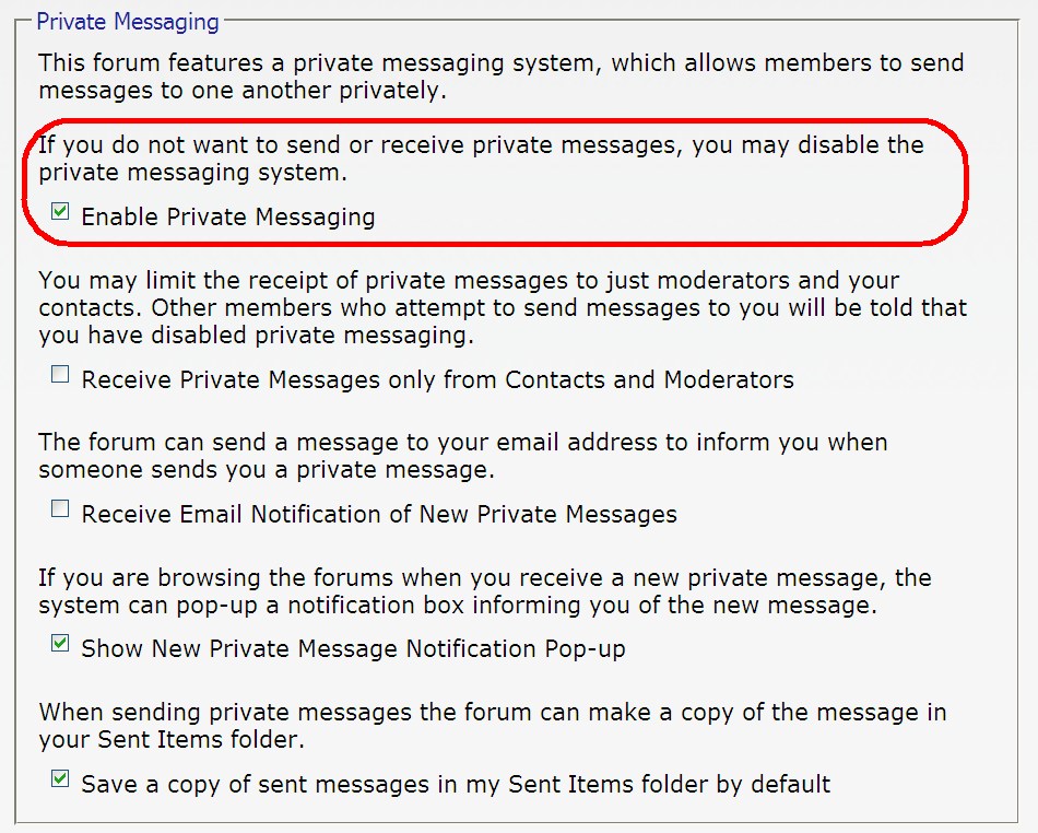

Originally Posted by kakkalla View Post
I don't understand. I am new to forums.
I have a tick in everything in my CP panel. Do I need to add your name specifically somewhere?
You would find the selection under edit options (see attached). It could be a limitation of the forum before x number of posts.

Old 01-20-2011, 08:14 AM   #22
kakkalla
kakkalla doesn't litterkakkalla doesn't litter
kakkalla's Avatar
Posts: 146
Karma: 194
Location: Melbourne
Device: iPad
I have that ticked. The problem is that I had the one below it ticked as well. I have now removed the tick.
kakkalla is offline   Reply With Quote
Old 01-20-2011, 08:22 AM   #23
DoctorOhh
US Navy, Retired
DoctorOhh's Avatar
Posts: 9,897
Karma: 13806776
Location: North Carolina
It works now I just sent you a PM. We just cross-posted the last couple of posts.
