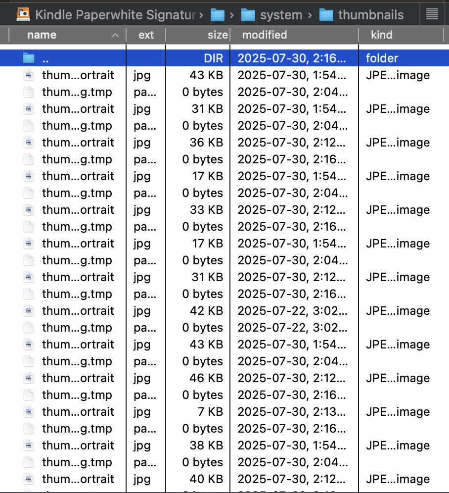

- when i connect it to my MacBook pro - kindle is not seen in finder, but Calibre does see it - i can send the books to the kindle (send to device) but they don’t have a cover (thumbnail). They are readeable nevertheless. - the artwork is functioning because with the same mac and Calibre I send the same books to my own Kindle Voyager and Kindle Oasis and works on both of them flawlessly. (well, maybe 1-2 in 10 books misses a cover, but not ALL 124 of them) - i tried transforming them in .azw3 and sending them - i tried emptying the thumbnail folder manually while connecting to a win computer (on which unfortunately I cannot install calibre) - i tried the .mobi again - i have factory reset the kindle - i transfered the books while on airplane mode and then connected to wifi - kindle firmware is up to date and it's registered Everything fails to send the thumbnails. I gave up but promised my friend I will try to help her after the summer vacation. Any suggestions, please? I'm using this for 15 years and never had an insurmountable problem lile now. ![]() p.s. Calibre version is 6.22.0 and I don’t want to upgrade from fear of not having to update my deDRM plugin and not making it work (it happened with previous updates and it was too difficult to resolve) Last edited by Amaia; 07-04-2025 at 05:35 PM. |

That the Mac does not mount it but calibre sees it strongly suggests that it is using an MTP connection. So no exposure of the thumbnails folder.

I keep my PW 12th Gen offline and on firmware 5.17.1.0.4 and I can see the thumbnails folder and the cover-bug folder when connecting on my Mac using Commander One.
