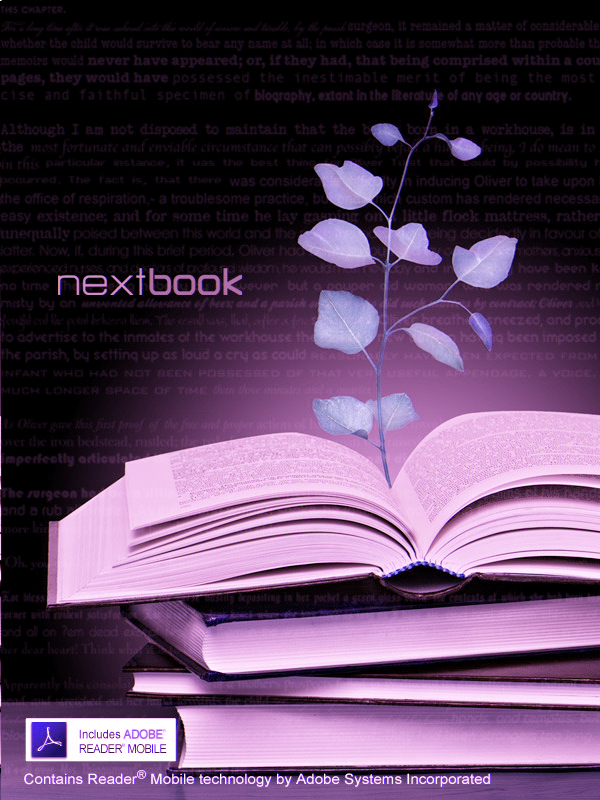

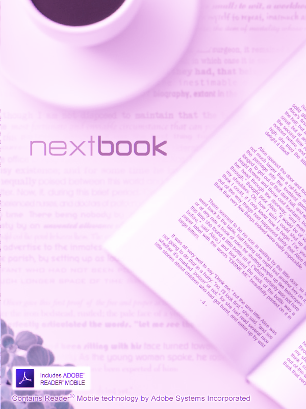

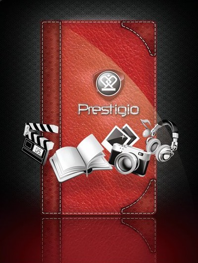

My old Next1 will soon become a more vibrant PER3072B...
I will be updating the firmware of my Next1 1.0.00 to PER3072B's latest v2.2.2 and in doing so I bid farewell to the old Next1 startup/shutdown pictures (24-bit .png with alpha transparency)
ID:	64715 Click image for larger version
in favour of the new PER3027B startup picture.
