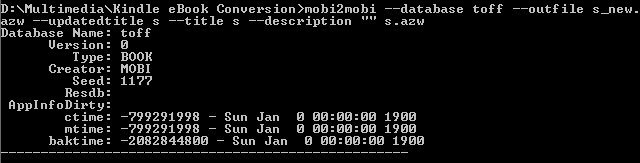

I've been using the GUI for some time quite happily. Then I tried to use it yesterday with a book I just bought from Amazon. It froze up. So, further experimenting - it would freeze up with books I had previously successfully edited using it. So I went to the command line version - and IT froze up (see attachment). Again, it froze up processing books that I'd successfully edited using it before.
Any suggestions? It appears my installation is now completely broken I'm using v0.09.
In case there's something wrong with mobi2mobi itself, where can I download it (not the GUI, but mobi2mobi.exe itself)?
