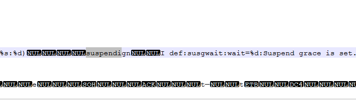

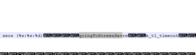

I edited the file and used command /etc/init.d/powerd start, however not worked properly.(nothing changed) I first copied the file to pc then edited with notepad++ and replaced using winSCP.
ID:	70477   Click image for larger version
