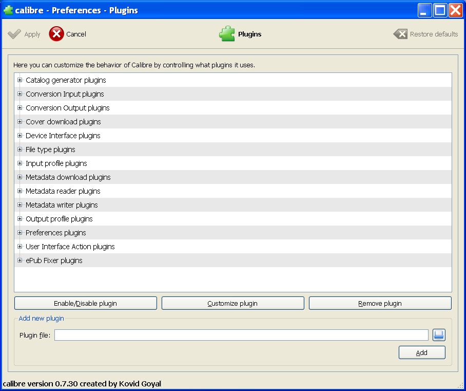

Ok, I'm another newby having minor issues. I've read through large portions of this thread, and thought I had myself sorted, but it's not quite going to plan?!
I currently have the 0.7.31 version of Calibre installed, and have downloaded the v2.2a version of AA's plugins downloaded to my computer.
I've looked at the readme file on how to get it into Calibre, but when I follow the instructional, Calibre wants to install the whole 2.2a zip file, rather than just the Calibre plugin zip file (which from looking at the readme is what I want to do??)
Also, can't quite figure out if I also need to download the Active State python installer, or if this only relates to previous versions.
All assistance much appreciated
You don't need to install Python.
The only thing I can think of about getting tools_2.2a zip when you select ineptepub_*_plugin.zip is that perhaps you have opened the zip without actually unzipping it. I seem to recall that Windows can do this. Make sure it is actually unzipped into actual folders. Alternatively, if you only see tools_2.2a zip perhaps there is a folder listed that contains the plugin. Drill down until you find it.
Thank you for the reply Wallcraft - I should perhaps clarify.
I've unzipped the 2.2a zip and found the plugin zip inside it(and then the specific zips inside that) when I look at it in the download folder. It's when I open it in Calibre, it wont let me open the main 2.2a zip to get to the plugins etc.
Now I'll admit I'm not very tech savvy, so I'm probably missing some really obvious step, but I am pleased for the help
Wenznz is offline   Reply With Quote

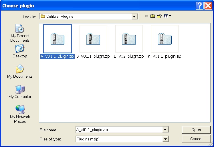

TIt's when I open it in Calibre, it wont let me open the main 2.2a zip to get to the plugins etc.
Are you in Preferences -> Plugins? Preferences in the gears icon. I can't show you the tools plugins, but the attached screen shots are what 4 plugins in a Calibre_Plugins folder might look like just before you "Add new plugin" to Calibre.
ID:	62098   Click image for larger version

Ok, big thank you to wallcraft and vulcan_girl for their help.
After I extracted the zip files out of the original zip into a new folder, and then figured out where to look in the plugins menu to see where they went, I'm golden!!
