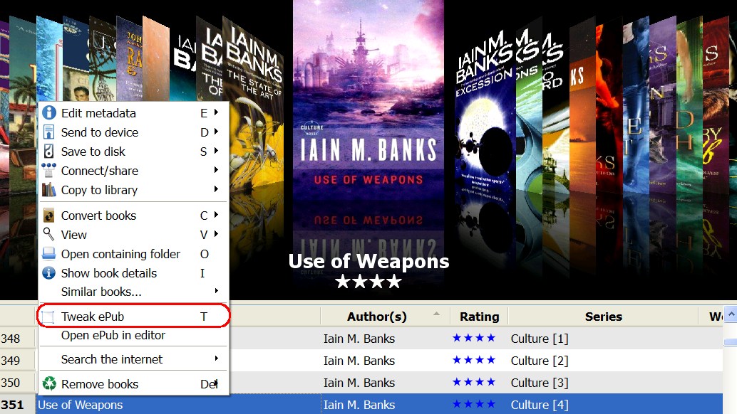

OK - I'm trying your method but failing to find the tweak epub feature :-( I have calibre open at the relevant book - cant see a suitable menu option anywhere ?
so tried 2nd route - could not get 7z to work - used winzip - found the css file margins - they look ok in there at 1st glance (5pt)
Right click on the selected book and choose tweak epub (see attached).
If you still don't see the option it means your version is older then 0.7.20 and you might want to consider upgrading.
