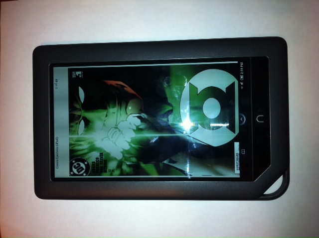

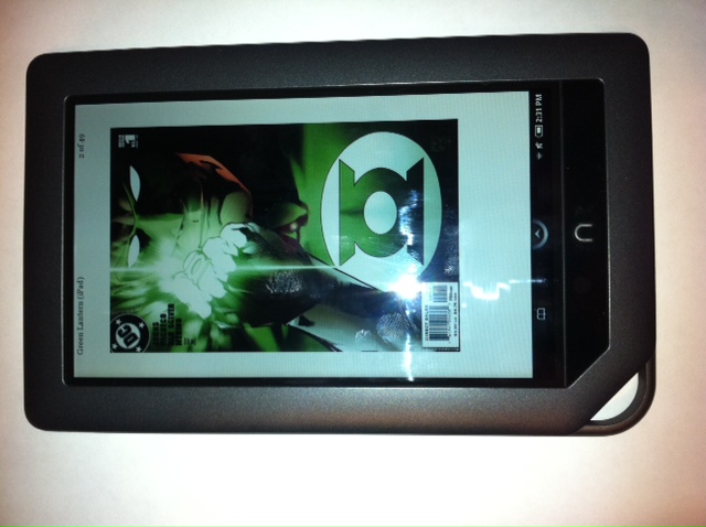

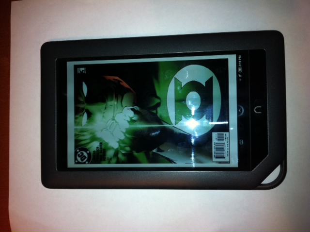

I am converting a lot of cbz files I have to epub for use on the Nook Color.
If I disable comic processing, then the converted pages fit on the nook screen just fine, however then I lose the ability to split double-wide pages.
If I enable comic processing, the pages get cutoff at the bottom. I have tried a bunch of different options on the comic input screen, but the pages always get cut off.
If I use the default output profile, then the pages look good, but they are small and do not use all of the screen available.
It appears that the nook color has the top 1/2" of the screen reserved for the header, plus the 1/4" navigation bar at the bottom. Therefore the use-able screen dimensions are 600(w)x898(h).
I hope this is something that is easily fixed.
Thanks again for a great app...
Pictures of what it looks like...
The cover, which scales nicely:
The first page (duplicate of cover), using nook color profile & comic processing:
The first page (duplicate of cover), using default output profile & comic processing:

currently the screen size is 980(h) so its probably smaller than. I'll change it to 900 for the next release, hopefully, that will do the trick
