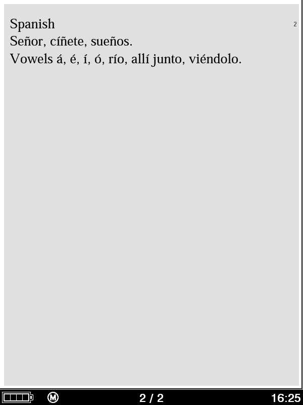

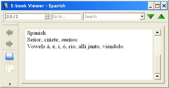

@zephyrot,
As a heavy user of making MSWord work with Calibre, I have to say that 'encoding' is one of the few things which has never given me a problem. So I wonder if we might go back to square one.
I have attached a tiny epub (created from MSWord to Webpage-filtered) with some Spanish chars in it.
The first image below is what it looks like in the Calibre viewer. The second image is a screencap from my Sony PRS505. As you can see the Spanish chars display correctly.
I'm afraid I don't have any experience with iPod or Stanza but perhaps you could do the following simple test as a first step:
  1. View the attached epub in your Calibre viewer and confirm that it looks OK on your PC.
  2. Transfer it to your reader in your normal way. Is it still OK?
If 1. is OK and 2. isn't then the problem is at the iPod/Stanza end not the Calibre conversion. If both are OK then we need to take a closer look at your source file and the conversion settings.
