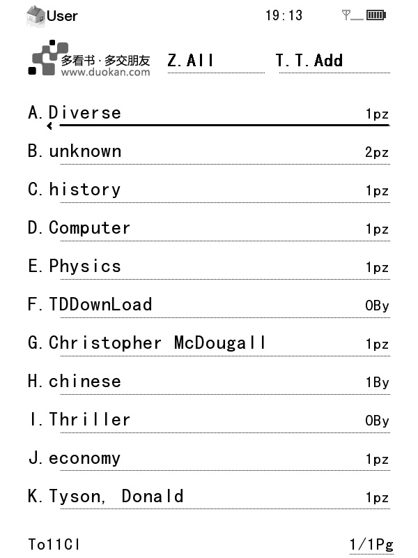

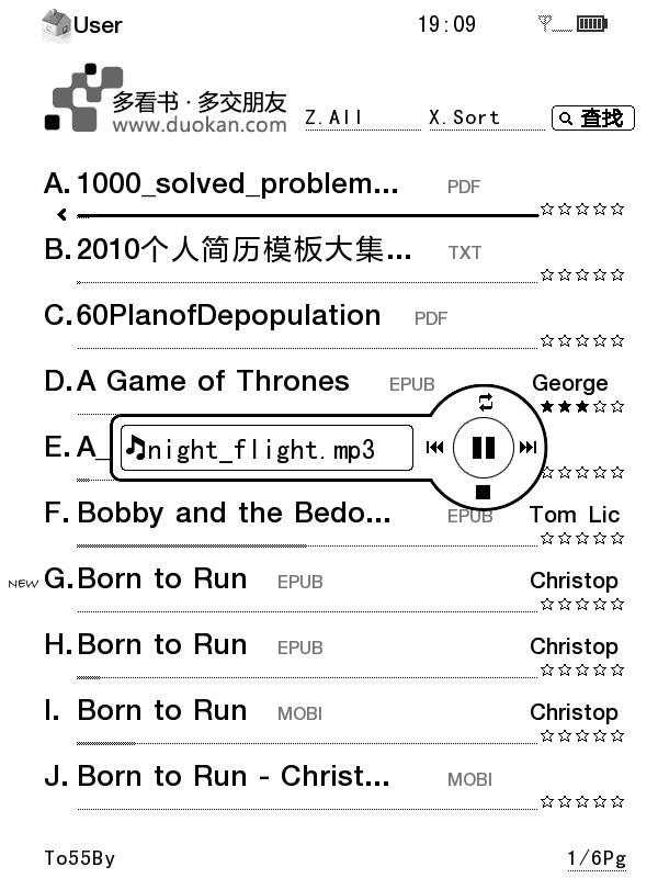

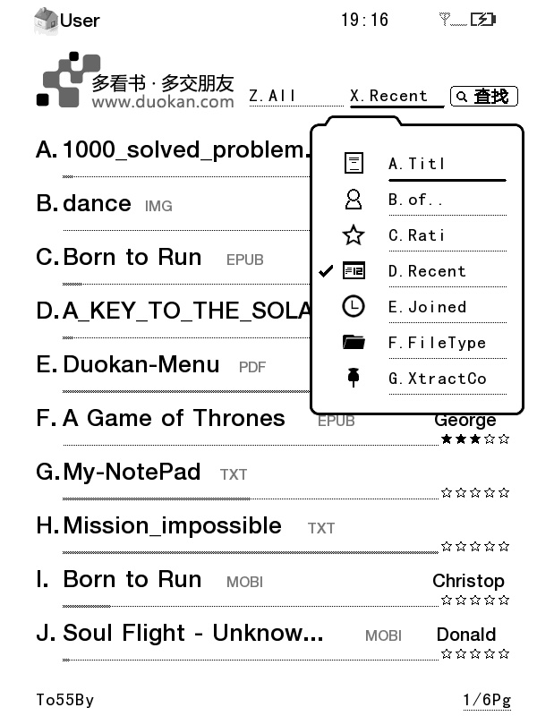

Originally Posted by SunLight View Post
Is anyone else having this problem? After installing Duokan, when I go back to Kindle 3 firmware, when I select a book it no longer goes to the top of the page as it usually did - sort "By Most Recent First" but rather goes to a different part of the order - say instead of going to the first book in the list it goes to the ~ seventh book???
And when I remove a book from a collection, it disappears but when I check the Kindle Drive, there it is.
Reread your input here, SunLight - I have never noticed anything like this under the Amazon system. You are sure about this ? What you say does match the Duokan however. At the top of the home page, (see attached page) where you can search, sort, and set what you want to have shown on your home page. It simply sound like you may have been in Duokan.
Sorry, if boring and perhaps too many screenshots, but thought I could add something that may be used in FAQ/Manual - what ever. But in fact, it was your pages I was interested in seeing... somewhat ironic...
