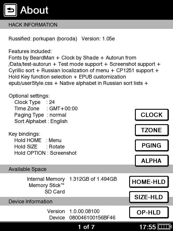

Originally Posted by elcreative View Post
Should be a note about it and maybe where you select to have it on or off... it's just a key combo that you can press at any time to record the screen and then you can transfer to your computer...
Got it - how very clever. You can map this to a particular button by choosing which button you want to use (About Menu) and toggling through the options. Currently this is mapped to the Options key in the example below.
Thanks for the question - without it I wouldn't have thought of looking for the answer
