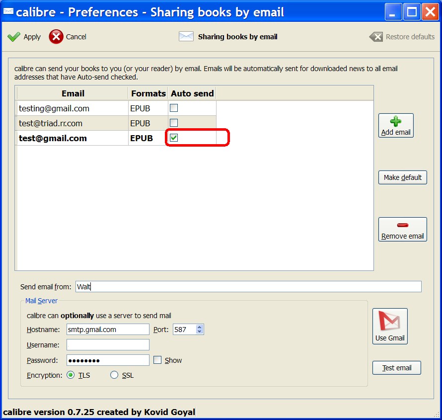

Do you have auto send checked (see attached)?
DoctorOhh is offline

^Yes, I have the autosend checked.
What if I right click one of the news/book from the lib >> Connect/Share >> Email to xxx@free.kindle.com!! Is it not going to send the selected news/book? Thats what I'm trying to do.
This should work. If you can send to your personal non-kindle email account then the only thing I can think of is a typo in your send address, your from address or in your Amazon account where you set the from address of the email accounts you allow to send to your Kindle.
