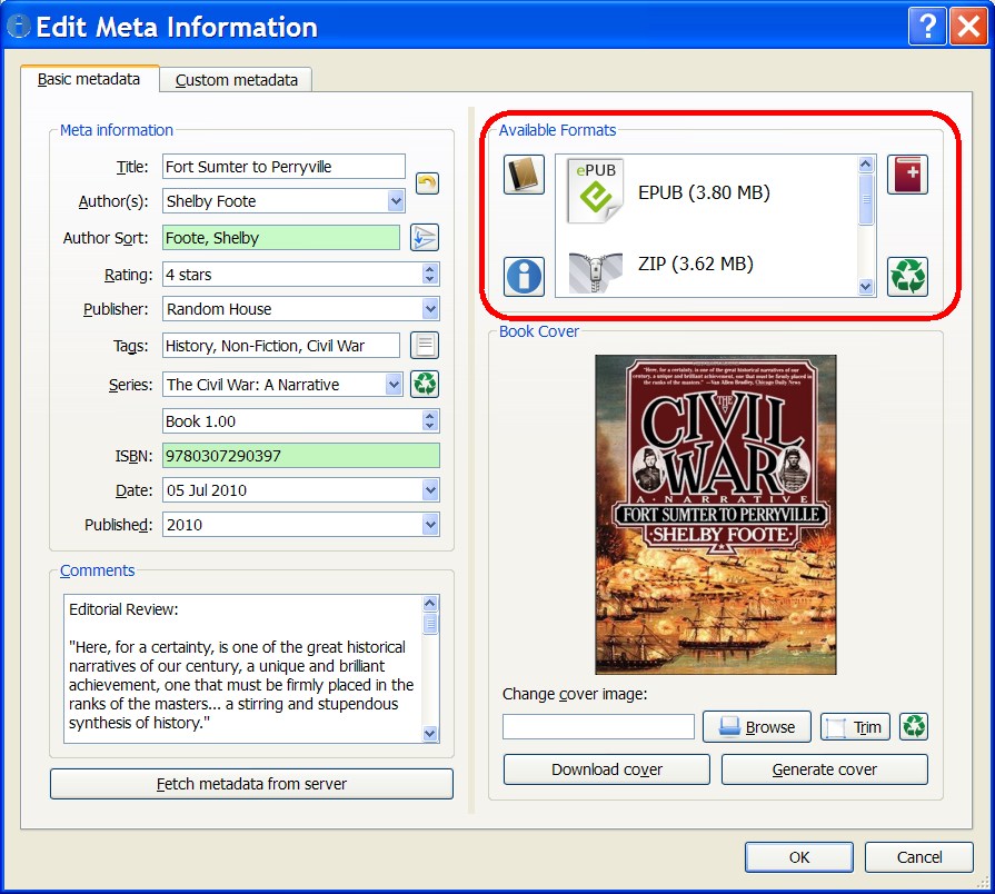

You actually see this book in your library?
When you select it what formats exist for this book? To find the formats select the book and click edit metadata and tell me what you see in available formats area (see attached).
What format is the book you try to add?
When you select the book and say remove is the entry deleted?
Did you reboot your computer and try to remove the book?
