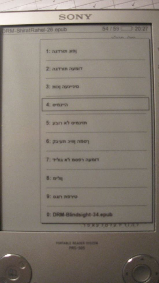

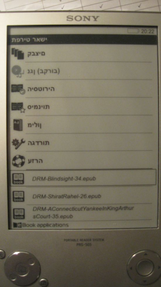

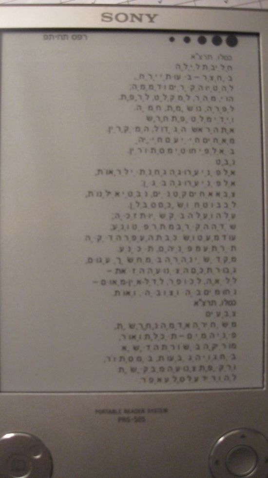

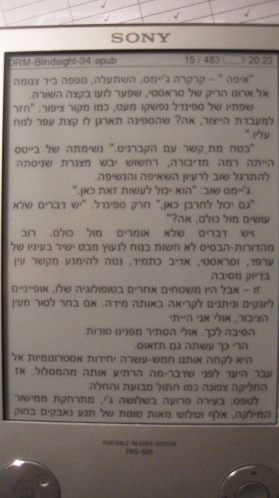

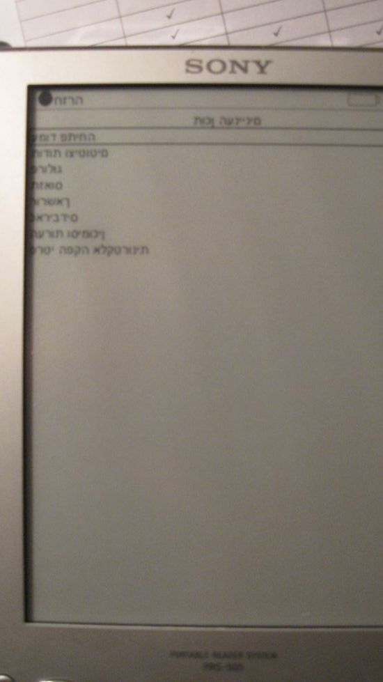

Below are a few photos I took (very bad photos, I know...) that demonstrate the current status and issues I found:
1) The main device menu: The text is displayed left to right and therefore it is not readable in Hebrew.

2) The book settings menu: The text is displayed left to right and therefore it is not readable in Hebrew.

3) TOC: The text is displayed left to right and therefore it is not readable in Hebrew.

4) Main Book Reading area: The text is displayed right to left and therefore it is readable. However, it's not reflowing properly. Lines are getting breaking without a real need (you can see it in the photo that a few lines has no period at the end). That's annoying.

5) Main Book Reading area - Text with punctuation marks: The punctuations are not being displayed properly. They appear to the left of every relevant character.
