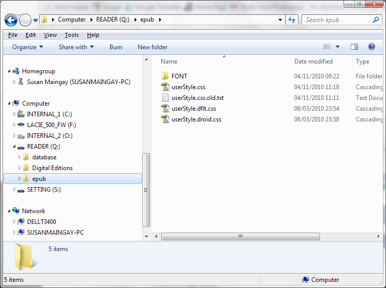

Hi - I've successfully applied the Russified Porkupan (boroda) V 1.05e firmeware hack, but (call me stupid) can't see any alternative fonts. The clock's there on the bar + the "About" menu shows that I'm using the Hack version and there are apparently options for:
CLOCK
TZONE
PGING
ALPHA
HOME-HLD
SIZE-HLD
OP-HLD
... but tap as I may, I don't seem to be able to get these to do anything to happen (apart from the screen flashing a moment). Holding down Size or Options does the rotation thing OK + holding down Home produces Go-Back when reading. However, I can't for the life of my see how you get at font options or see how you control things like time-zone / time settings.
If I'm being really dumb I'd be grateful if someone could enlighten me on what I should do next - great that the 650 wasn't bricked by the process, but it would be nice to go to the next level. Do I need to edit options in any ot the .bat programs? At the moment I feel a bit like a kid sticking wet fingers in the electric socket to see what will happen next
induna kindly listed the steps to change fonts using firmware 1.05e in this link (post 14). Perhaps, you missed a step?
https://www.mobileread.com/forums/sho...d.php?t=105194

Really grateful for the quick response. I've edited userStyle.css to read (as there's no Bold Italic in my Garamond set, I've left this as Droid):
@font-face {
font-family: -ua-default;
font-weight: normal;
font-style: normal;
src: url(res:///Data/epub/FONT/garamond/GARA.ttf);
@font-face {
font-weight: bold;
font-style: normal;
src: url(res:///Data/epub/FONT/garamond/GARABD.ttf);
@font-face {
font-style: italic;
src: url(res:///Data/epub/FONT/garamond/GARAIT.ttf);
@font-face {
font-weight: bold;
font-style: italic;
src: url(res:///Data/epub/FONT/droid/DroidSerif-BoldItalic.ttf);
@font-face {
font-family: "sans-serif1";
src:url(res:///opt/sony/ebook/FONT/tt0003m_.ttf);
h1 {
font-family: sans-serif1, sans-serif;
My flashed Reader has the file structure as in the screen shot I attach. But I'm still getting the old Sony default font! I've tried this across a range of ePub books (mostly from Feedbooks) and have checked in Calibri that there's no local font over-ride... I have to say I feel a bit confused. If anyone can clarify where I've gone wrong I'd be really grateful. Very odd.
chris_tribble is offline   Reply With Quote

I had the same problem with my 650. For some reason the userstyle.css just wouldn't work for me.
What I ended up doing was changing
to
font-family: DroidSerif
and below the @font-face rules, added
body {font-family: DroidSerif; line-height: 1.2em}
You could (maybe even should...) use font-family: serif; instead, to catch cases where the epub file specifies a serif font.
However, if someone tells me how I can get -ua-default working, I'd love to know.
sherman is offline   Reply With Quote

I've tried following this in order to get Garamond working - and I'm still only getting the Sony default font (I've tried a hard-restart).
Would it be possible to post the full userstyle.css you're using? I could then see if I can at least get Droid working, and then see if I can tweak things from there. At the moment I'm not getting past step one.
The next question is going to be how to re-set time zone etc when travelling. At the moment the Reader gives me the correct UK local time (picking this up from the computer?). But I'd have no idea of how to change if this was needed. However - this is episode 2 of the adventure. At the moment I'm still stuck at the home base.
