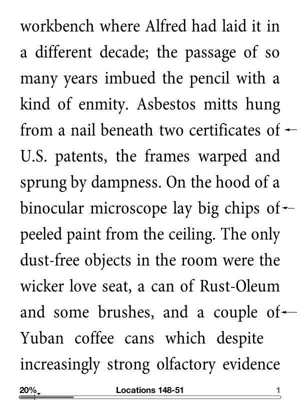

I managed to clean up a few of the fonts I was trying out by selecting 'Remove kerning' when converting them to TTF using Font Squirrel. This helped a lot, making the fonts much crisper on the Kindle.
One problem I keep running into, though, is that the terminal on the lower case 'f' is systematically chopped off whenever it appears at the end of a line. I've seen this now in five different fonts.
Changing the margins and justification doesn't seem to help either.
I've attached a screenshot here of Minion Pro Condensed.
Is anyone else running into this? Any ideas on how to fix it?

@veezh: Tweak the bearings for that character in a font editor, maybe? (Fontforge :P).

[QUOTE=NiLuJe;1123042]@veezh: Tweak the bearings for that character in a font editor, maybe? (Fontforge :P).
Thanks for the tip. I've finally managed to adjust the right bearing for the 'f' character. Very fiddly, but it worked a treat.
