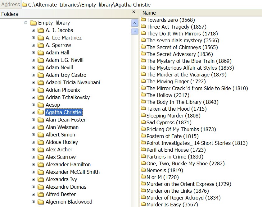

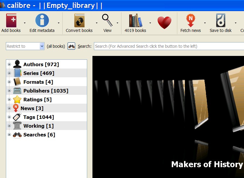

No, calibre won't create blank folders.
Ok, folks are starting to not understand things.
Calibre will, in fact, create empty folders, based on the metadata.db file. Try it yourself. Create an empty library, exit calibre, place a large metadata.db file in the completely empty library (mine had 4019 book) in place of the recently created metadata.db and when you start calibre it will populate that empty library with a complete folder structure that matches what the metadata.db file says should be there. There won't be any files but the entire folder structure will be created (see attached).
This must be done before calibre notices that the folders are missing and changes the db.
Calibre does not change the metadata.db file to match the existing folders, it changes the existing folders to match the metadata.db file. It will create folders to match the db but not delete or change any existing folders.
ID:	58613   Click image for larger version
Just did. You are right. And I think that calibre should not do this.
