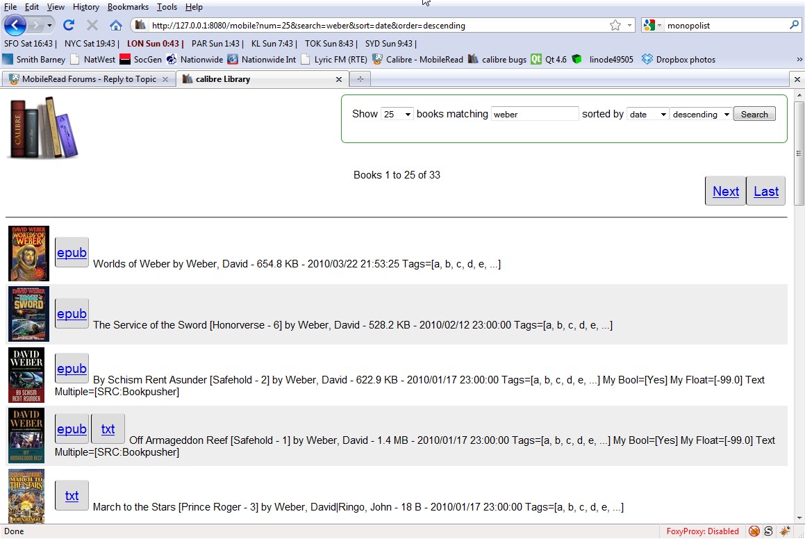

Is there any way to sort or search on tags in the content server?
Are you using your K3? And are you seeing the mobile version? (How do you know? You see a list of field names, including tags.)
If you are, then one way you 'search' by clicking on the category, then the value.
Not having a Kindle, I can't know if you see what I see. That said, when I connect to the mobile site, I see what is shown in the attached screen shot. There is set of boxes across the top that handle searching and sorting. You should be able to type into that box any search expression that calibre will accept.

type
tag:whatever
in the search box
Aha! I'd tried a couple other things, but was using = instead of :. Thanks!
TuxGirl is offline   Reply With Quote
Chaley:
Ah! Great! I wasn't looking at the mobile version, since I had the version of calibre that didn't default the kindle to the mobile version, but now that I'm looking there, it looks good.
Thanks!
