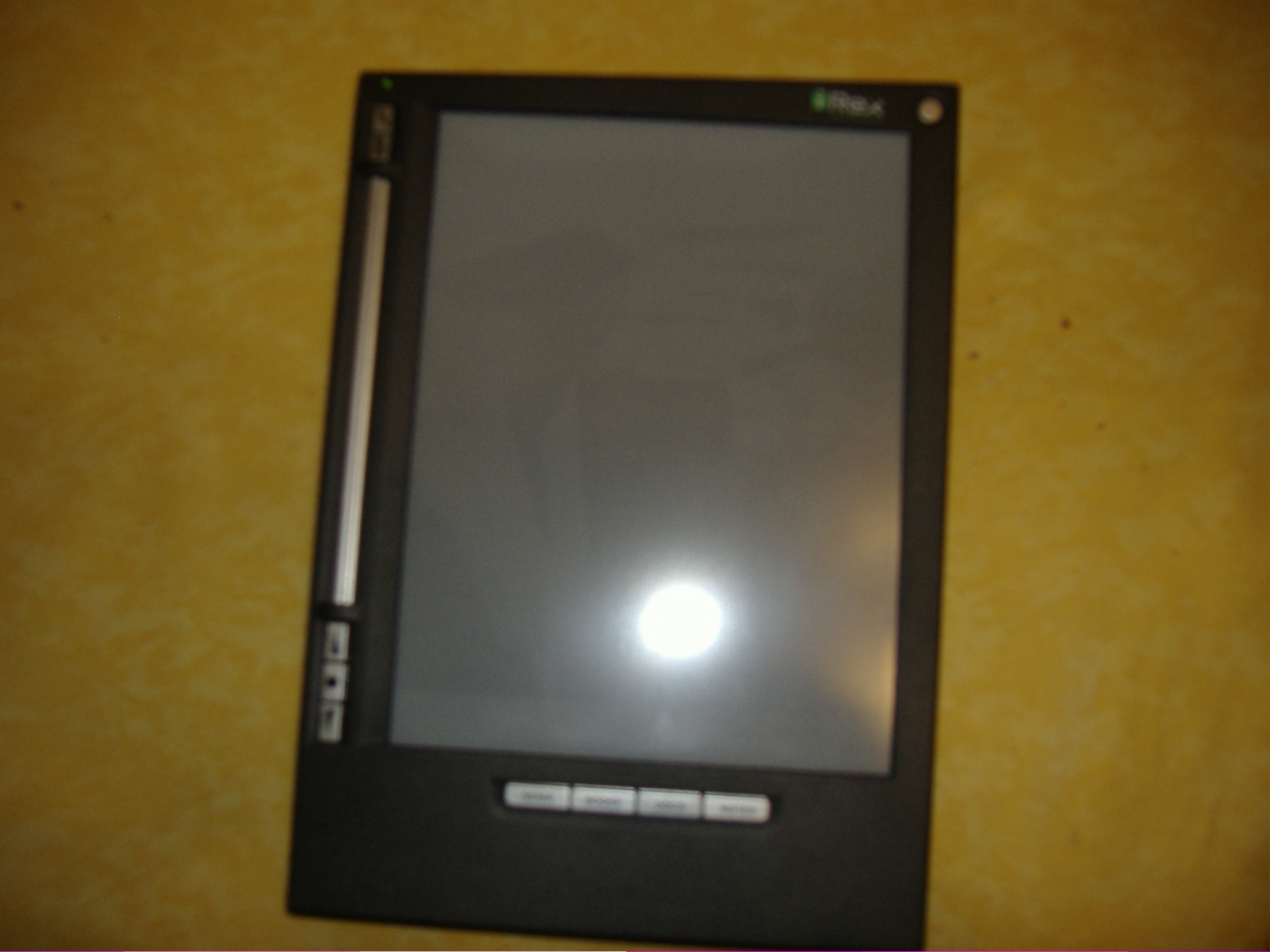

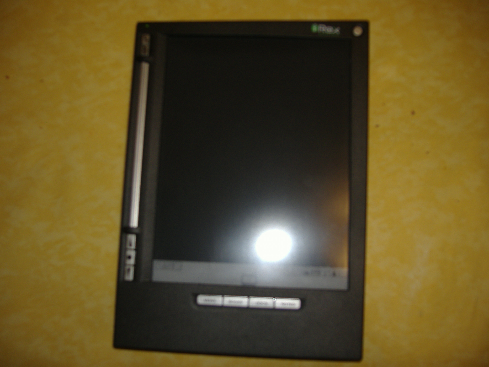

I have installed the new script and my Iliad don`t start. What can I do?. I`m afraid my Iliad is k.o.

What happens when you try to start your iLiad?

That's odd. I can't imagine why the contentlister isn't starting.
You have firmware 2.11 correct? You should be able to reflash it yourself with a compact flash card.

Yes 2.11 and I have a compact flash I don´t know reflashing. Can you help me ? .Thanks

get the reflash image from here: https://myirex.irexnet.com/user.php/attachments
Then unpack the ZIP file to your flash card (it needs to be fat32 formatted)
Then hold down the connect button (round button) while you are switching on the iLiad and keep it pressed for quite some time.
The iLiad should then boot from the CF card and reflash the device.

You can find detailed instructions here: http://developer.irexnet.com/dev_fil...CF howto_0.pdf

Only half solution. I have reflashed my Iliad and then I recovery but is v2.10.Well when I try to update I have the problem again. I think that there is some program that run in the boot sequence and it look the version if this is 2.11 and then...
After reflash I don´t have shell access.
Any sugesstions?
Maybe I must wait v2.12
Many thanks

When you do the recovery, backup all of your document that are on the internal memory, and use the "format" option in the config.txt. It could be corruption on the internal file system. A format may solve it.

Thanks a lot Adam and Tribble, at last all it´s o.k.
