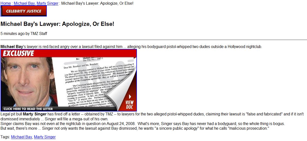

Starson17, I thought I was getting the knack of this but apparently not. If it is an indent problem then hit me. I don't think it is though but I can't seem to understand why the print is not being appended to the url. I looked at the newyorker as an example and I to the most part use the same print_version()

I also am using the the test you gave me of
ebook-convert tmz.recipe output_dir --test -vv > myrecipe.txt
I don't really see any errors in there and I also don't see the print_url is: ... either
Sorry to bug you I will get it one of these days.

Originally Posted by TonytheBookworm View Post

I ran your code. It puts these in the output file:
print_url is:  http://www.tmz.com/2010/08/18/tmz-seinfeld-uncle-leo-crank-call-police-burbank-kim-kardashian-facebook/print
print_url is:  http://www.tmz.com/2010/08/25/mel-gibson-extortion-case-oksana-grigorieva-domestic-violence-sheriff-district-attorney-investigation/print
AFAICT, it's working perfectly. I even tested one of those links, and it works, too. What do you think is busted?
notice is the attached screenshot. that up top I have Home: Michael Bay.... I know I can remove the tags to get rid of that. And also down at the bottom I have tags:Michael Bay ... etc.
The reason I suspected that it is not hitting the print_url is because when i navigate to the page manually I do not see any of those tags at all (as in if i look at the original html /print version) However, I do notice the tags if I do not append /print . Any thoughts?
notice that when you goto http://www.tmz.com/2010/08/24/michae...r-pistol-whip/
You will get the div tag of <breadcrumbs> that i wish to remove.
But when you go to http://www.tmz.com/2010/08/24/michae...tol-whip/print
You do not get the div tag of <breadcrumbs> maybe I've got an indention problem going on here that just isn't obvious to me or something but for sure something is going on
I'm a dumb_____ for whatever reason the recipe that i posted to you is the correct version. geany didn't save it yet I thought it had. I went and opened it back up after rebooting my computer today and noticed i still had the old version haha. Live and learn. Sorry for trouble.

Working copy of TMZ
Here is the tmz.
File Type: rar tmz.rar (959 Bytes, 267 views)
