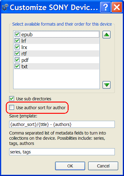

I believe you are both correct. To use author_sort on your Sony vice author you have to go to Preferences - Plugins - Device interface plugin - Sony device interface and customize the plugin. See attached image.
To fully convert every book on your reader you may have to delete the books and reload them after you customize the plugin.

[QUOTE=dwanthny;1036214]I believe you are both correct. To use author_sort on your Sony vice author you have to go to Preferences - Plugins - Device interface plugin - Sony device interface and customize the plugin. See attached image.
It tried what you explain in the Sony PRS-600 Device and it works but in a strange way.
First it seems not to work since the books added where sorted by author name. But the next time you reconnect the device an add a new book the older books magically are ordered by author sort, with the name of the author being "surname, name" and not "name surname".
Only the new added book appears with "name surname" layout in the author name, but this changes when you add a new book. Shutting down the device doesn't arrange the situation, only adding a new book changes de author name of the rest.
Should this be a candidate for a bug ticket?

What is the 'manage metadata' preference set to: manual, on send, or automatic?
Are you referring to the display on the Sony or calibre's device display?
Manage metadata is at "manual". Should it be at "automatic"?
The display on the Sony device
superplinio is offline   Reply With Quote
