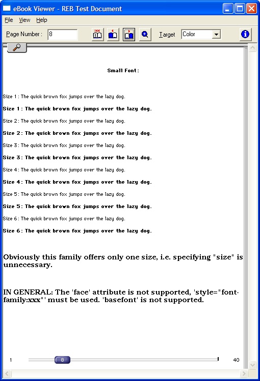

Old 07-23-2010, 09:53 PM   #743
nrapallo
GuteBook/Mobi2IMP Creator
nrapallo's Avatar
Posts: 2,958
Karma: 2530691
Location: Toronto, Canada
Originally Posted by dwanthny View Post
This causes code to scroll right off of the screen. It's a feature not a bug, designed so the code is presented exactly how the programming book wants it seen. The trouble, a reader is only so large and this code prevents wrapping before the end of the given code.
If the right margin on the ebook reader is NOT honoured, then it's a bug!
If the user has many books like this a combination of a larger reader or landscape vice portrait might be in order.
Another mode of attack would be to change the font to a fixed point and be as small as is legible, so as to fit the max. amount of line text on the screen before it runs off. If the original .chm had a finite length (which is common for letter-sized pages) then perhaps this approach may work. In my reader, I would simply use:
<pre style="font-family: smallfont; font-size: xx-small">...</pre>
and the text would appear like this Click image for larger version
Within .epub files, that syntax may have to be change to something like
<pre style="font-family: courier; font-size: 1">...</pre>
If this doesn't work, then cropping the lines or reflowing them would be the only alternative (other than getting a large screened ebook reader... ). That's why you would need to remove the <pre> tags, reflow the text using <p> tags and then manually breaking each line with <br /> to avoid them running into each other.
Any way you do it, if the original (e)book was not formatted for small screened ebook readers, then doing so afterward will NOT yield good results! That's why I avoid .pdf ebooks at all cost even though they are wonderfully presented and visually stunning most of the time; substance over form?
