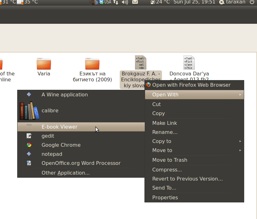

Hi,
I noticed earlier that the Calibre icon in "Open With" submenu is huge, much larger of any other icons there. I noticed this on Ubuntu and Debian (with Gnome, don't know about KDE). Is there any way to remedy this and scale the icon down, or disable the menu integration completely?
Thanks.

I can confirm this on ubuntu 10.04, here's a screenshot attached:

After some searching and experimenting, I concluded the following:
1. The icon which should be resized is this one: /usr/local/share/icons/hicolor/128x128/apps/calibre-gui.png
There is another one in: /usr/share/icons/hicolor/128x128/apps/, but it seems that it doesn't have to do anything with the issue at hand.
2. It seems that the icon is far too large (554x449 px) for Gnome (?) to handle it properly. After resizing it to 142x128 px menu looks normal.
I hope this will be of use as a temporary solution.
Kovid, is there a way to solve this automatically during the installation? Maybe some kind of DE check so, when Gnome is used, a smaller icon is provided instead of the big one?
Also, as pointed out by theducks, another icon, calibre-viewer.png is completely messed up (see the attachment). Why is that?

Never mind, I've committed a fix.

Downloaded Calibre 0.7.12, the issue with icons is gone. Thanks a lot, Kovid, for your quick response.

sorry to drag up an old thread but this seems to be happening again on calibre 2.3/2.4 with gnome-shell 3.14 on debian jessie/sid
sej7278 is offline   Reply With Quote
Old 09-30-2014, 11:51 PM   #15
Posts: 46,546
Karma: 29634066
The large size icons are needed as they are also used as dock icons, so I dont really see a way too solve this. There is no guarantee that installing multiple sizes for the icons will make the menu pick the smaller size, not to mention that the there is no way to know what size of icon the menu requires, since I'd guess it depends on DPI and user settings.
The GNOME developers really should learn how to resize icons in their menus.
