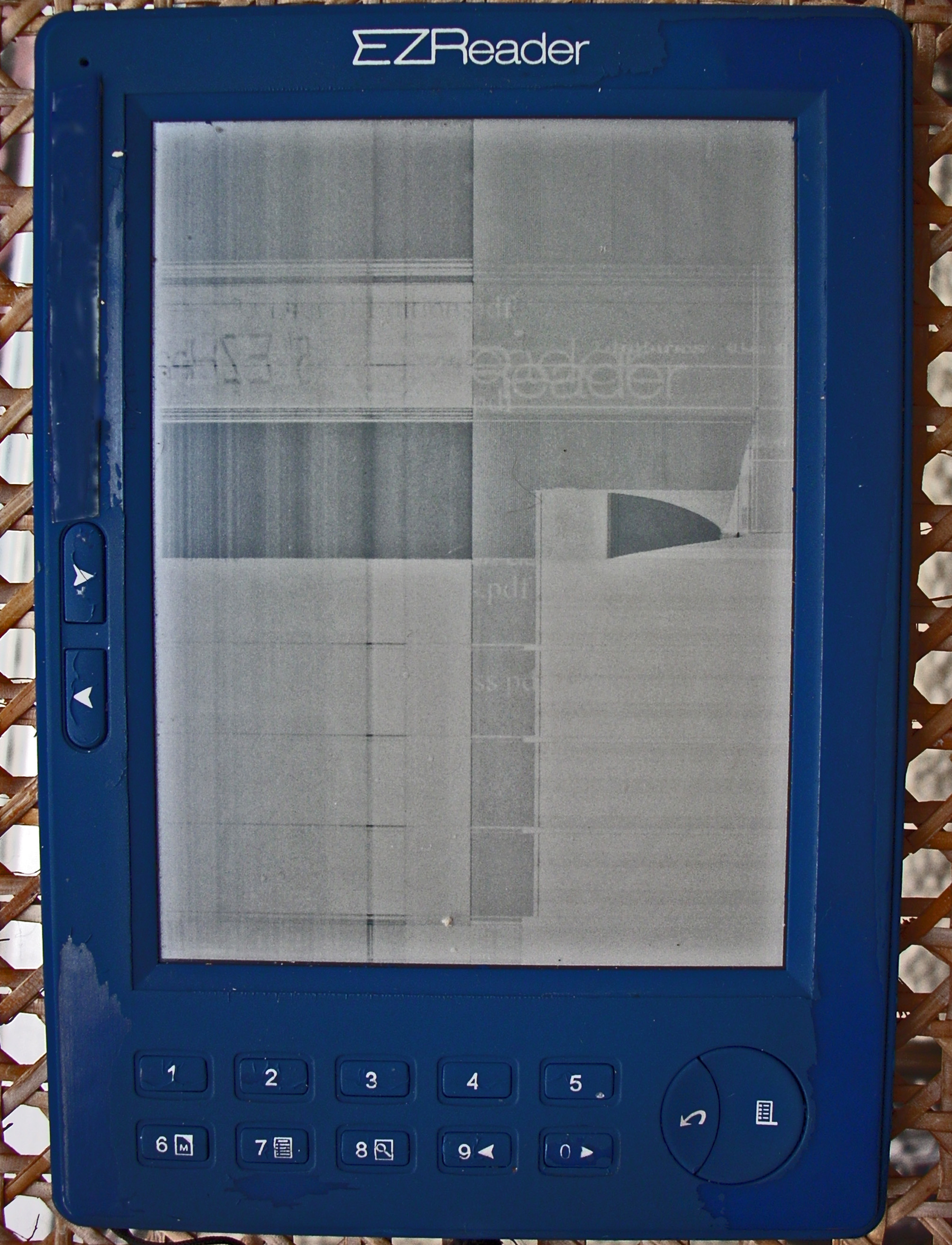

Well, this started out as a supposed similar problem, listed all the things I had done (on/off, firmware update reset, reset button. Then I discovered a soft spot in the screen where the "arrow" is pointing. So I have erased all that stuff, but left the post in case someone read it and might then scratch their heads as to why it disappeared.
Not sure how it happened, but it appears that somehow something impacted the screen thru the cover, so I will be contacting Astak yet again to send it in for repair. Or maybe buy a new one. Sigh.
Problem is that I just left on two weeks vacation with the intention of reading along the way.
Just so happens I will be in San Jose tomorrow, so perhaps I'll have the opportunity to work something out in person. Not looking encouraging, since its been about 3 hours since leaving two messages with Astask and I haven't heard a thing back.
Ouch! Geezer.
I hope your books are on the SD card.
Beware. Astak is just a few blocks from the Fry's on Brokow.
I don't think they normally man the joint on weekends, so I hope Monday is good. You have to ring the bell to gain entry (common for industrial park buildings)

Yes, all my books are on the SD card, although in my testing (before noticing the dent in the screen), I had occasion to connect via the USB port and was able to guess when to press what button to make it happen.
If I didn't hear back from Astak before leaving Hayward for San Jose this afternoon, the Brokow Frys was precisely where I was considering looking for a (non-Astak) replacement, so knowing now that Astak is close by will give me the opportunity to at least fruitlessly ring their doorbell, first.

I learned after trying to contact them last Friday morning when I was within 30 miles that they aren't open on Saturdays (I finally got an email from "support" on Tuesday telling me so, but the email didn't include an RMA even tho I had explained the screen was broken and repair is the only option, so I gave up and waited til I got home.)
Since my sole complaint is the total silence in response to two phone calls which should have at least gotten me the information that they were closed on Saturday, I've decided I should at least wait for an example of true poor customer support, rather than bad timing, before abandoning Astak completely.
So of course, I got home from vacation late Friday night and here it is another Saturday allowing me the opportunity to wait til Monday to contact them again.
And now here is another choice to be made -- spend $200 on the latest and greatest EZReader Plus, or send the PPro in for repair? Warranty sez at least $95 for a new screen plus I own the shipping both ways. With the Plus not available til Aug 14, of course, there is no telling which would get to me sooner -- the "repaired" PPro, or the new Plus.
Although I waffled a bit about maybe getting a $149 nook rather than paying $100+ for repairs and then waiting to see how long it would take, doing further research I still feel Astak is still the better choice for my purposes. And buying a nook cover would make the price difference a wash, anyway, now that the Plus price has been announced. Of course, I saw that the Sony Pocket Edition was down to $149 as well, and with a metal case, perhaps my screen wouldn't have broken. hmmm.
So I have all weekend to decide: $100+ for repairs or $200 for new. Of course new would be 1" bigger, but it would be NEW, lol.

On Monday, I got an RMA from support after a little phone tag, shipped the PPro by late afternoon.
On Tuesday, we got the announcement that Robert's knee operation apparently missed the target and his name is now Jenifer. In adjusting to the change and the way it was announced, my whining about support got Jenifer's attention.
On Thursday (today) I got a phone call from support asking for my cc info to pay for a new screen on the PPro. I have now received an email informing the PPro has shipped, along with a tracking number.
Because of slow and lack of response, as well as non-responses in the responses I did receive prior to Jenifer's involvement, I am sure that Jenifer had a hand in the quick turn-around , and I only await the arrival of the unit by Saturday so I will have a reader when I go off to Summer Camp with my BSA troop on Sunday.
While I am sorry to see Robert go , and I feel somewhat disloyal to him after all his loyalty to us, I thank Jenifer for whatever part she played in getting my PPro issue resolved in a timely fashion once I was able to drag an RMA out of support.

Okay,
All you folks refusing to leave your computers in anticipation of my last post in this matter, I got my "repaired" EZ Reader 5" Pocket Pro.
"Repaired" because it is a brand new, fully clothed in plastic, all pieces included, never been opened before, unit. I suspect this might be because, in addition to the broken screen, 3/4 of the paint had also peeled. Since the inside of the Cover is gray instead of the light tan of my previous one, I am sure this is the new cover that no longer peels the paint.
Got it on charge til morning and will throw in my SD card, load up books I have purchased while waiting (like the 300+ I got free in the Holiday Package, and numerous other unread purchases and downloads aren't enuff), check the FW, and start reading. Shoot, I will even be able to read the two library books I had borrowed before I left on my vacation during which the screen broke the second day.
One-week turn-around from support after all the disappointing stories we have heard, I can only but credit to Jenifer's attention. (Sent in Monday, back on Saturday).
I am probably more excited than I was when originally I got it for Christmas. For one thing, it is just in time to go on vacation, whereas it was just new at Christmas time.
