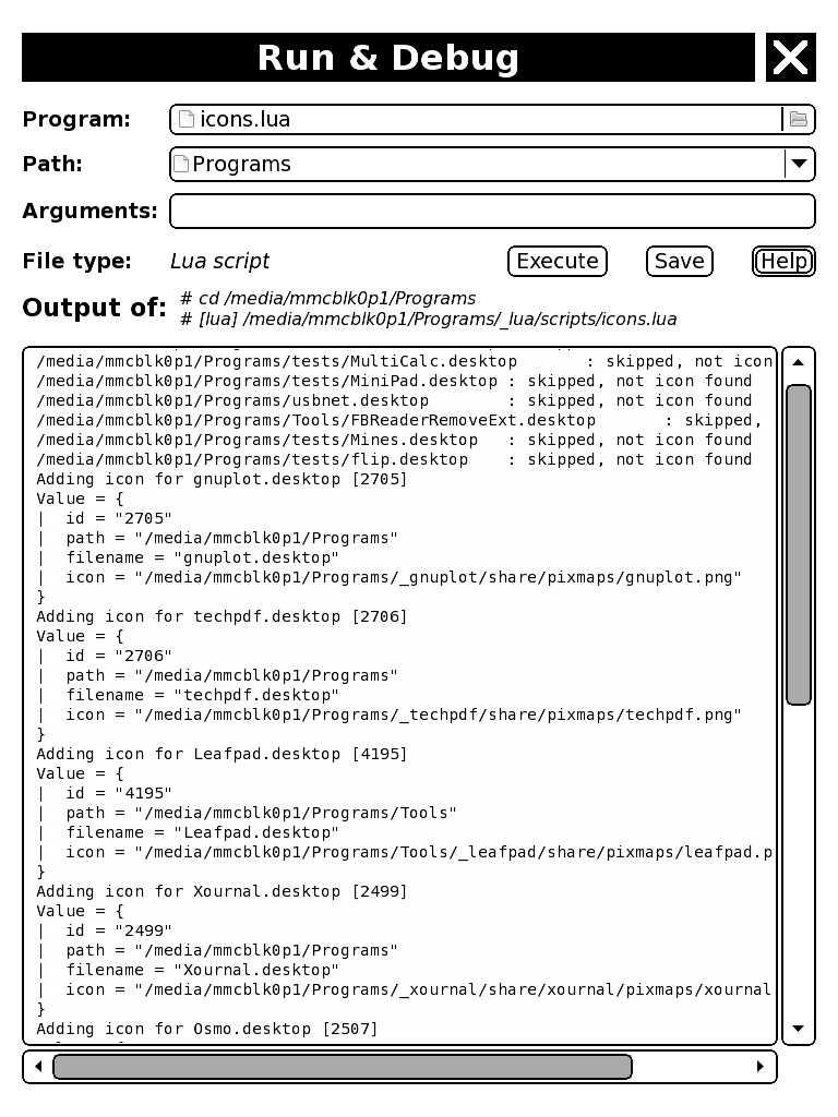

Well, in fact this is not a proper release, as both of these applications are included in Lua megapackage (https://www.mobileread.com/forums/showthread.php?t=79273) since version 2.
Anyway, I think they deserve enough interest to have a proper announcement
RunDebug (aka run_debug.lua)
This application lets run some other programs and get the output. It is specially useful to execute command line based scripts or to check why some applications don't start properly.
It understands some special types of files like lua, python or shell scripts. Even it can run the proper command if you select a .desktop file! More help inside the program.
To run, start from its own .desktop file once lua package is copied to the ereader, no command line needed.
icons.lua

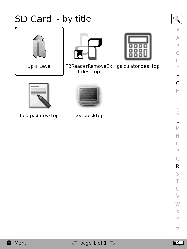

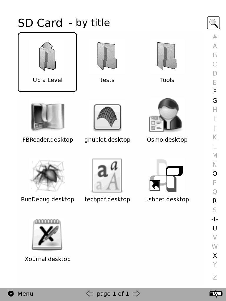

A simple script which parses .desktop files looking for Icon entries. If those point to a valid .png file it will modify device database so the device will use those images as icons from now on.
To execute, run it from RunDebug (it's in <SD card>/Programs/_lua/Scripts), exit and enjoy your new world of beautiful images!

I immediately tried them on the DR1000 (with firmware R2 beta) they behave as expected. I really would like to have as much icons as you have, can you post the bitmaps with the desktop files, that would make it much easier for others (and me ).

I hope "as expected" means "ok"
All my released packages already contain their icon. Look at _<package>/share/pixmaps/<package>.png. That's the usual location for them in Linux.
The other icons shown in the screenshots not present in their original packages are gnuplot, rxvt and techpdf. I've attached the images I use.
Anyway, my recommendation for every packager/porter is to add themselves the image they prefer, it's quite easy:
- Add an image in .png format to _<package>/share/pixmaps/<package>.png
- Add a line to the end of the <package>.desktop file containing something like:
Icon=/media/mmcblk0p1/Programs/_<package>/share/pixmaps/<package>.png
and from the user perspective is just a matter of reindex the contents of the DR in case it is a new package and run "icons.lua".
