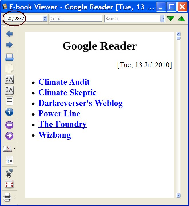

Now I need some help from someone who knows something about Google Reader.
Step 1 was to retrieve the auth code. I needed to change the request a bit from the old recipe, but that was successful.
Step 2 was to use the auth code and add it in as a header to each request. That was a pain. I got the header in OK, but it wasn't authorizing. For one thing, the API specs as to the exact format weren't very clear and for another, the mechanize docs weren't very clear, and for a third, unless you ask the right way, the auth code you get in step 1 is wrong. Usually, I can watch the headers when I retrieve from a website, then just do the same thing, but this is a program interface, not a browser interface, and I don't have anything working in the browser that I can copy.
Nonetheless, I was able to get it authenticating by changing the original request and copying the header format I found in a blog.
At that point, I expected success, and I suppose I may have it, but there's no content
I can retrieve an authenticated page at:
http://www.google.com/reader/api/0/tag/list
That's where the recipe gets the feeds.
The recipe then builds URLs for a feed list. Here's some feeds that it built:
(u'National Review Blogs', 'http://www.google.com/reader/atom/user/18271557450980043868/label/National%20Review%20Blogs?n=50&xt=user/-/state/com.google/read'),
(u'North Carolina', 'http://www.google.com/reader/atom/user/18271557450980043868/label/North%20Carolina?n=50&xt=user/-/state/com.google/read'),
(u'Watts Up With That', 'http://www.google.com/reader/atom/user/18271557450980043868/label/Watts%20Up%20With%20That?n=50&xt=user/-/state/com.google/read'),
However, these don't seem to have any content. I have no idea why the recipe builds these particular URLs, and since I'm dealing with a programmatic access to the Google Reader, not a browser access, I can't copy a successful browser session. Perhaps the recipe should build some other URLs for its feeds from the contents of the page at http://www.google.com/reader/api/0/tag/list, but if so, I don't know what it should build? Maybe my test account needs to have articles tagged or marked in some special way to show up at these locations?
Alternatively, maybe I need some special cookies for the content to show up?
It would probably be a heck of a lot easier for me to just rewrite the whole dang thing from scratch trying to base it on FireFox browser access instead of this API.
If anyone knows the URL that the recipe should be building for each feed, let me know. If you want to test further, replace the get_browser in the recipe with this:

@Starson17 Your work helped me a lot and I think I know how to fix this but I still need your help to write python code. You are on the spot with fetching the AUTH token.
The issue is after the " def get_feeds(self): " method. We get the various feeds here and then each feed is queried to get articles/items under them. The request to those feeds DOES NOT pass the AUTH token as a header. And so, if you look at the log in jobs list then you will see that, google redirects these requests with a "302 Moved Temporarily" and sends to the login page. So we never get to the list of items in the feed.
send: 'POST /accounts/ClientLogin HTTP/1.1\r\nAccept-Encoding: identity\r\nContent-Length: 97\r\nHost: www.google.com\r\nContent-Type: application/x-www-form-urlencoded\r\nConnection: close\r\nUser-Agent: Mozilla/5.0 (X11; U; i686 Linux; en_US; rv:1.8.0.4) Gecko/20060508 Firefox/1.5.0.4\r\n\r\n'

First a big two thumbs up for getting this working.
Now the reason the two recipes should not be combined.
The reason I used the Googlereader and not Googlereaderuber is because Googlereader recipe doesn't have the reading list. Read this post for details. The bottom line is because I have my subscriptions in folders this recipe (first post) now downloads all my articles twice and I end up with a book that has about twice as many pages as a result.
Update: The attached images are the exact same articles downloaded today with the two different recipes. Even though the second has about 33% more pages the actual size wasn't much larger (7.9M vs 8.5M) so I guess I'm not locked into having two recipes.
One recipe could be fine but if someone thinks they will be able to easily navigate through the mess that is the Reading List with "uncategorized" articles and all of the rest of the "categorized articles"... well it is practically useless.
Of course until they learn how to place their feeds in folders at least they will be reaching their goal of grabbing articles using Google Reader.
