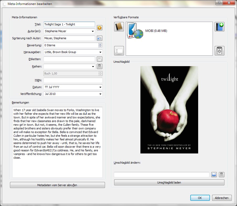

Seems I found someone with the same problem: title on kindle is different from title in metadata (changed with calibre or mobi2mobiGUI)
Attached the screen of my Twilight copy - Author displays and sorts correctly, but the title shows on my kindle as "Twilight" and not "Twilight Saga 1 - Twilight"
So far, I found no solution to this yet.
hmmm maybe I should have made this it's own thread then.
Pushka I will try deleting them from the Kindle and then restarting and see if that works.
