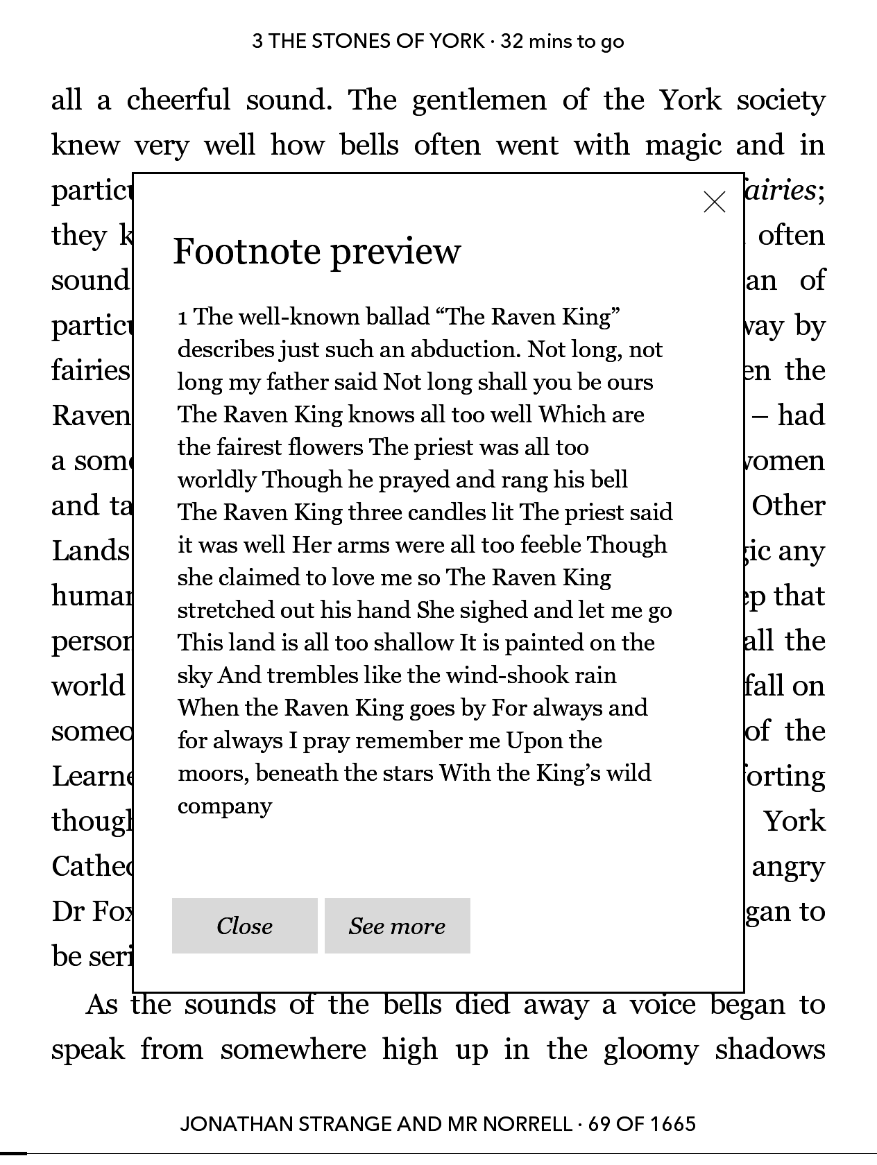

The experience of reading them is a bit odd. Most cause a footnote pop-up to appear. A few, however, send the reader to the footnote "chapter" of the book, where in order to return to the book location I need to use the breadcrumb thing at the bottom of the screen.
All the footnote pop-ups seem to ignore the paragraph marks and all css styling and show up as a left justified wall of text, yes even the poems, which is pretty terrible.
Also, when the content of the pop-up footnote is long, which is pretty common, there's a scroll bar you can use all sorts of gestures to move to the next/previous pate of the footnote, but if I use the physical buttons on my Libra H2O it flips the pages of the book underneath(!) the footnote page, which is very strange.
That's the way it's always been on the eInk Kobos, I'm afraid. the footnote pop-up widget seems to be of the PlainText variety rather than RichText.

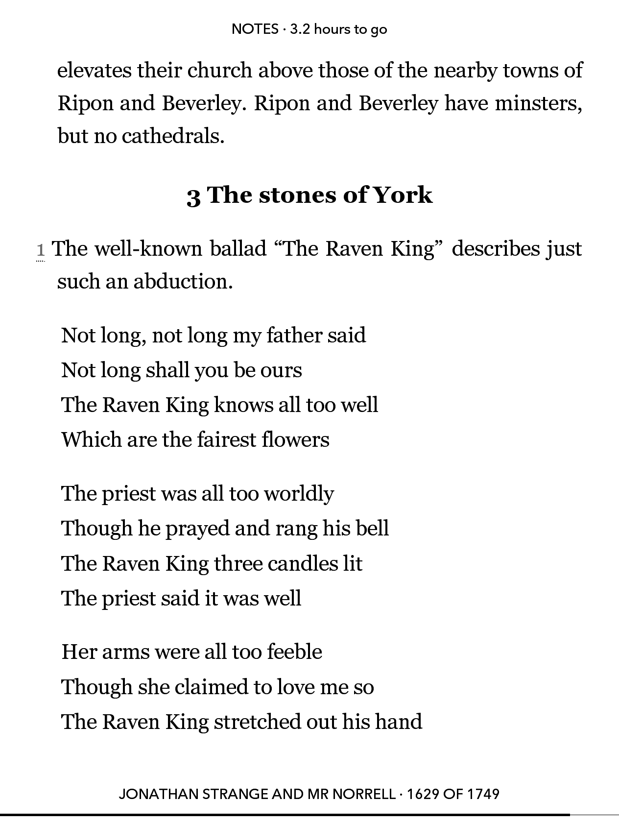

As promised, I attached a couple of screenshots demonstrating how bad plain-text footnotes pop-ups can turn out to be.
Now I wonder how best to fix this pop-up inconsistency. Here's the html snippet for the footnote in the screenshots, for example:
