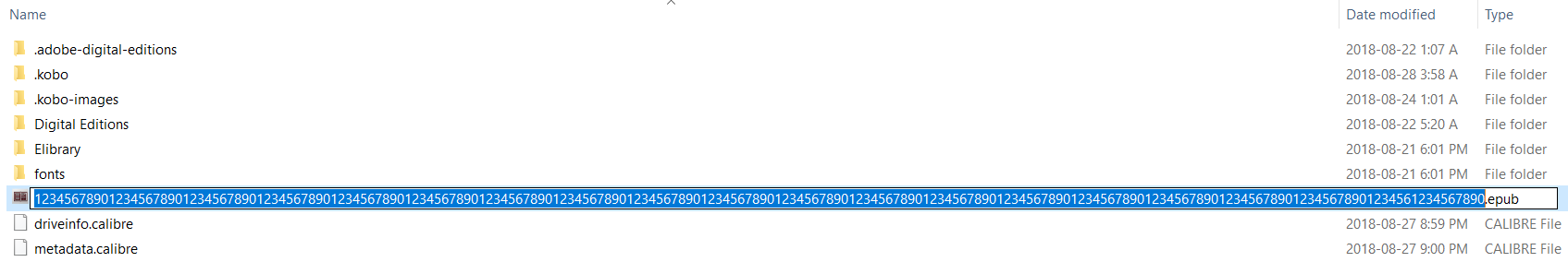

I found a problem in that it KA1 changes or truncates the title if it is considered "too long"; the database setup get confused or mangled.
e.g. "Risou no Himo Seikatsu Volume 05.epub" is listed on the KA1 as "Risou no Himo Seikatsu V05" in the book list. but "Risou no Himo Seikatsu Volume 06.epub" got listed as "Risou no Himo Seikatsu Volume 05.epub"
For "13 Mahouka Koukou no Rettousei #13 - Steeplechase Chapter (B-T)(Roah)-v2.epub", KA1 book list truncates to Mahouka Koukou no Rettousei #13.epub"
Looks to me like KA1 has a limitation on file name size. Will have to do another factory reset & not load my light novels as the KA1 is unable deal with long file names like an Android tablet. Or perhaps it is just the nickel app.
Hmmm... the filename limit is 255 bytes on a FAT32 partition. Since you are copying the files over, I would suspect that the filename munging is from your computer. I just tested on my Clara HD since it was handy and copied a file with a 196 character filename (plus the . and extension) and it was not truncated.
However what your Kobo uses in the book list is not related to the filename. It is derived from the metadata embedded in the epub file you are transferring over to your device. The 240 character filename file that I transferred over was correctly named Out of the Vortex with the author name showing as Steve White and the series showing as Her Majesty’s American 1.5 (the series took a second connection to update the metadata after the book had been imported into the database) in My Books.
Check out calibre for correcting metadata along with either Sigil or calibre's editor using Flightcrew (Sigil, epub2) or epubcheck (Sigil, calibre editor, epub2 or epub3) to locate and correct errors in the structure and content of your ebooks before sending ebooks to your Kobo. Or even use the QualityCheck plugin for calibre to do some basic checks.
For epubs, the device reads the metadata from inside the book. It will only use the file names if there is no metadata in the book. If you are getting those names in the books lists, then there is something wrong with the metadata in the books. Either it is missing, or it set incorrectly. When you send a book from calibre, the metadata should be updated to whatever is in the calibre library. This can be disabled,
The file name limitation is the same as the path limitation for the file system in use. In this case, the files system is FAT32 and the name length is 260 characters or something like that.
Calibre will massage the file names and paths to keep well within this limit. This is taking into account the directories in use, so it can give much shorter file names. But, that does not affect the metadata within the book.
The file name massaging that calibre does is to also remove characters that might be a problem. It will replace these with an underscore. The "#" in the above file name makes me uncomfortable, so I have just done a test on my Glo HD to check it is handled properly.
And as soon as I read this I did remember a problem with long names. While the path name limit is 256 or 260 (can't remember where the extra 4 goes), the practical limit for a book is much shorter. This is because of the generated images. These are created with the full path of the book plus an identifier and an extension. And they go in a subdirectory. Because of this, the KoboTouch driver uses 185 characters as the maximum path length. There is also the files in "Digital Editions", but I thing this length covers them.
It's been ages since I tried this, but some strange things do happen when that books path length is to long. And it is because the path for the cover images is to long. I don't remember exactly what happened and would need to experiment.
