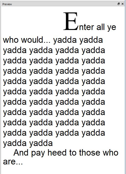

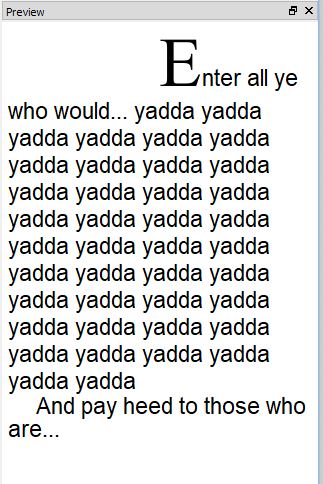

Have you tried this?
<html xmlns="http://www.w3.org/1999/xhtml">
<head>
<title></title>
<style>
p            {text-indent:1.2em; margin:0; padding:0; line-height:1}
p.first      {display:inline; padding-left:50%; text-indent:0}
p.first span {font-size:3em; font-family:serif}
</style>
</head>
<body>
<p class="first"><span>E</span>nter all ye who would... yadda yadda
 yadda yadda yadda yadda yadda yadda yadda yadda yadda yadda yadda
 yadda yadda yadda yadda yadda</p>
<p>And pay heed to those who are...</p>
</body>
</html>
It seems to do what you want - at least within Sigil.
Cheers,
edit:pictures added
ID:	158406   Click image for larger version

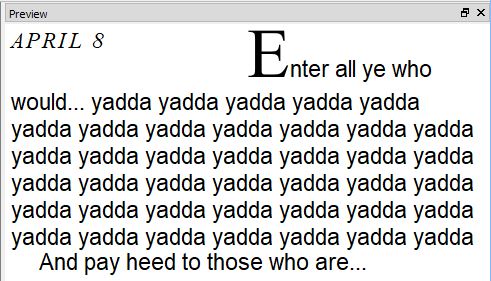

Lining up the date and the top of the raised initial should just be a matter of giving the date a negative bottom margin - such as:
<style>
p.date       {text-indent:0; margin-bottom:-1.5em; letter-spacing:.1em;
              font-style:italic; font-family:serif}
</style>
</head>
<body>
<p class="date">APRIL 8</p>
...although I think Amazon barfs on negative margins??

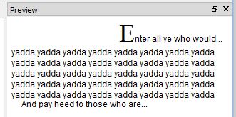

I'm unclear about why your 47% isn't working--it should be. I mean...where is it NOT working, that you know of?
Wide and narrow letters. "W" is noticeably left of center and "I" is right.
The date and the E aren't on the same line--not at all. That's simply an optical illusion, created by the vertical height of the E.
Well, yeah, I know they are different paragraphs, but you need to use negative margin to get the top of the date to line with the top of the cap, and that's the way it was in the original book (Michael Palmer's Extreme Measures, from 1991).
For what it's worth, just as an FYI, what you're doing isn't a drop cap. It's actually called a Raised Initial.
I only use the "text-dropcap" name for the style because I use that for all initial caps, regardless of whether they are raised, drop, even floated outside the text.
Not even close. That "E" isn't centered:
<head>
<title></title>
<style>
p.center {text-align: center; font-size:3em;}
</style>
</head>
<body>
<p class="center">I</p>

Here's code for the "cap on separate para" version:
<head>
<title></title>
<style>
p            {margin:0; padding:0;}
.para-dropcap {
	text-align: center;
	font-size: 4.6em;
	font-weight: bold;
	line-height: 1;
.para-chapterFirst {
	text-indent: 54.5%;
	text-align: justify;
	margin-top: -1.75em;
	margin-bottom: 0.1em;
</style>
</head>
<body>
<p class="para-dropcap">E</p>
<p class="para-chapterFirst">nter all ye who would ... yadda yadda
<p class="para-dropcap">W</p>
<p class="para-chapterFirst">est of ... yadda yadda
<p class="para-dropcap">T</p>
<p class="para-chapterFirst">esting the centering ... yadda yadda
<p class="para-dropcap">I</p>
<p class="para-chapterFirst">n the still ... yadda yadda
</body>
</html>
You can see that the "E" looks good, the "W" is OK, the "T" is bad, and the "I" is terrible.
Since this causes text-to-speech to break while not completely fixing the formatting, I picked the way that kept TTS functional.
nabsltd is offline   Reply With Quote
