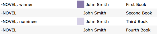

Let’s say my database contains 10 books by author John Smith. One of these books won a notable award, and is therefore tagged “winner”. This tag will allow for an icon to be added next to his name.
Is there a way to mark all remaining books by the same author with a second icon signify that this is an author of some importance, but without adding an extra tag?
I understand that I could simply add an additional tag to all non-winning books, even something simple such as a + sign, but that might require some maintenance down the line that I would prefer to avoid.
Example included.

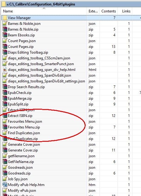

Can anyone tell me what the following line in debug is about. I haven't had an Apple anything since a IIe and Lisa 30 years ago, and I have never installed the Fanficfare plugin. And the file doesn't exist, see attachment
macmenuhack file_path:C:\_Calibre\Configuration_64bit\plugins\ fanficfare_macmenuhack.txt.
calibre Debug log

EpubMerge: DEBUG: 2017-07-07 19:03:42,163: calibre_plugins.epubmerge.epubmerge_plugin(152): macmenuhack file_path:C:\_Calibre\Configuration_64bit\plugins\ fanficfare_macmenuhack.txt
Started up in 5.49 seconds with 8347 books

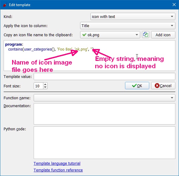

@chaley - l'll let the OP try the Advanced Rule route.
The attached image shows how to do it with an advanced rule.
Here is the template text shown in the image. The "Foo Bar" is there because that is the name of my test user category.
program:
	contains(user_categories(), 'Foo Bar', 'ok.png', '')
The advanced rule must return the name of an icon file, in this example ok.png, or the empty string for no icon.
