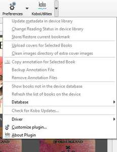

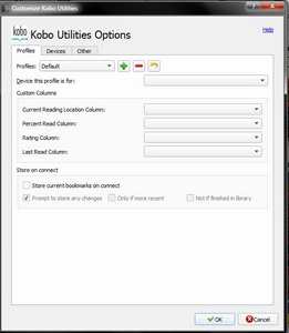

I have looked everywhere but I don't see anything that says "send comments".
(see attached pics).
I've clicked on everything meatadata and tried many combinations of update metadata, embed metadata, read metadata etc. Deleted the book, resent book, to no avail. No comments in Glo's detail tab.
All books are epubs, sideloaded.

The first screen shot shows the Kobo Utilities menu when no Kobo device is connected. Most of the options are disable because there is no Kobo device connected. But, the first option on the menu is "Update metadata in device library". When you connect a Kobo device, that option will be enabled, though it will probably be the third option. Then you:
  1. Find the books you want to update the metadata. They must already be on the device.
  2. Select them.
  3. Choose the "Update metadata in device library" from the menu.
  4. On the dialog displayed, choose what parts of the metadata to update. At the least, tou want to select comments.
  5. Press the OK button.
  6. After some time, depending on the number of books selected, a message will be displayed with the number of changes made.
  7. Eject the device and check the changes.

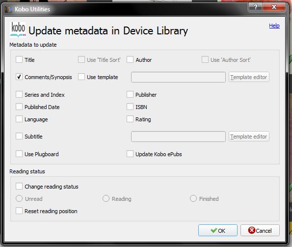

I don't get the sub menu asking what metadata to update.

The only way that I can get that to happen is if I don't have any books selected in the calibre library list. And that is expected. You have to select the books that are on the device to update.
If you have books selected and the options dialog is not coming up, then I need a debug log. Restart calibre in debug mode, connect the device, repeat what isn't working and then close calibre. The debug log will be displayed. Post the full contents for me to look at.

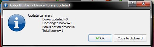

After finding the correct Update Metadata dialog, (red face here), I ticked the "comments" field, and updated the metadata on the problem book.
Ejected Glo; Nothing under synopsis/details for this book.
The comments for that book is large(utf8). Does the Glo have a size limit for synopsis/comments/details?.
I've attached some pics of correct update dialog, (I confused it with the update cached metadata, my mistake).

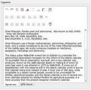

That log says nothing was changed, so the metadata in the calibre library matches that in the device library. Unfortunately, the logs do not show anything about what the plugin is seeing as the comments in the two places. That is because it sees them as the same. But, I had already prepared a test version of the plugin for someone else. Could you install the version in this post? That logs the comments not matter what is happening.
Again, to see the logs, you will need to run it in debug mode. But, can you run it twice. Run the update once and the log should show what the current comments are in the library and on the device. Then, make a change to the comments in calibre. Just add a word or something somewhere that will be easy to see. Then run it again and see what happens. Again the log will show what the comments and description are. Hopefully with this I will be able to work out what is going on.

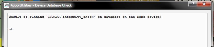

For completeness, can you do two things:
- In the metadata editor in calibre, can you copy the HTML source of the comment.
- Can you run the database check that is in the plugin. It's under the "Database" menu. It should display a window with "OK" in the text area, but if there are database issues, it will display something else.

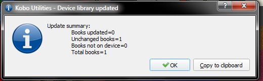

logs attached with no change to comments, then a minor change to comments.
After a minor change the comments show up in the Glo synopsis tab. with several blank pages.
EDIT:
I noticed that there was 10's of blank lines in the html code, e.g.
<div>
blank
blank
blank
etc.
then Comments start;
I deleted all these 10's of blank lines in the html code and the comments now show up in my Glo, 7 pages worth in the synopsis tab.
Many thanks for your time.
