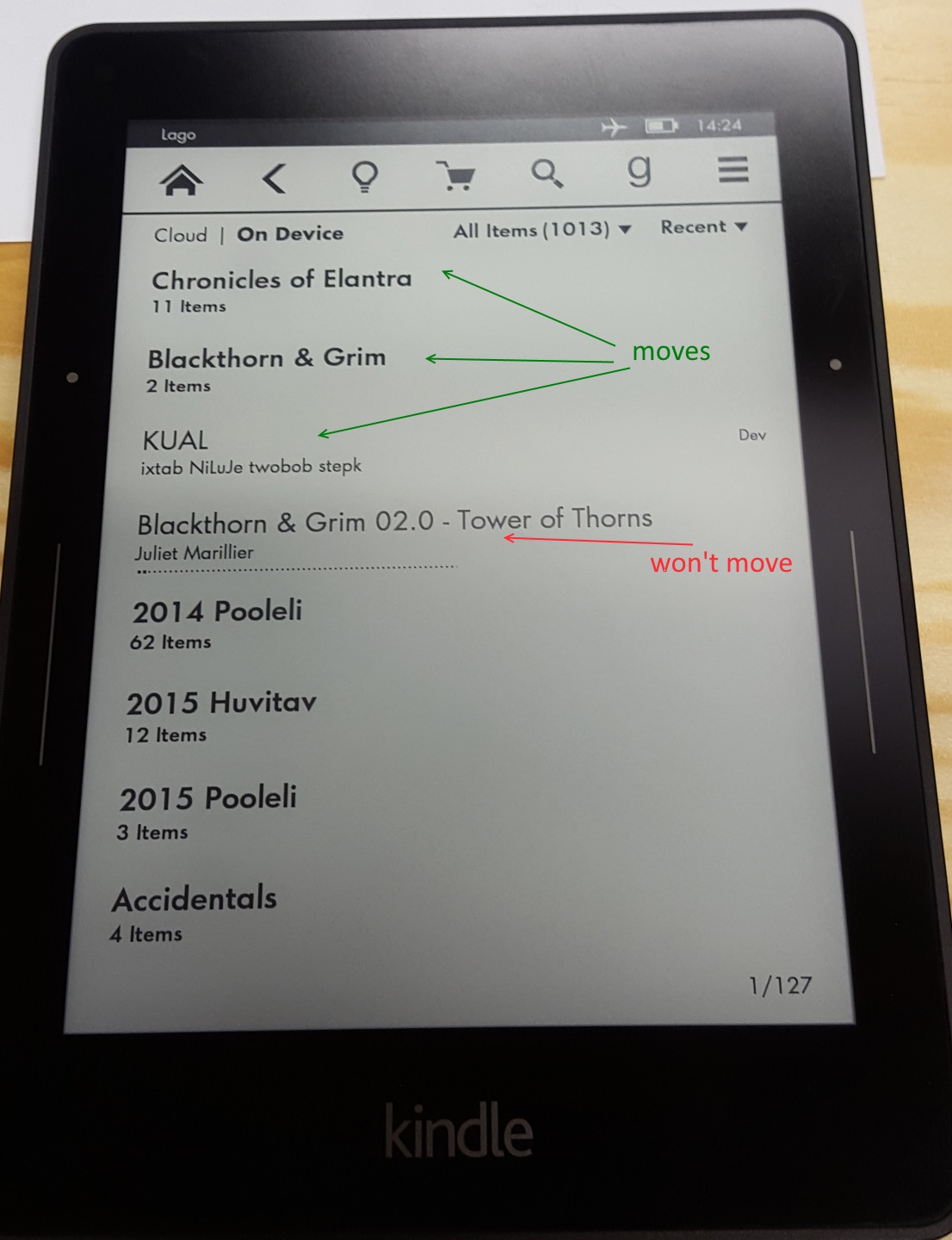

I just updated to version 5.6.5 it is jailbroken after the upgrade.
When I sort All Items by Recent and open a book that is 4'th in the list it should jump at the top of the list.
When I navigate back to the list, it's still 4th. When I open KUAL or a Collection it moves to the top of the list.
Has anyone experienced this problem or am I the only one? The sorting worked correctly in 5.6.2.1.
If I do a factory reset, will it remove the jailbreak?

Got the sorting fixed, thank you for the quick advice.
I set a new time from the menu (no date was possible to set) and it didn't work.
I briefly connected my Kindle to wifi and run sync. Then the sorting got fixed (I think it changed the date)
As to how I got to the state where recent sorting didn't work was:
  1. Registered my kindle (fw. 5.6.2.1)
  2. Disconnected wifi
  3. Upgraded to fw 5.6.5
  4. Serial jailbreak device
I was planning to never connect my Kindle to the internet again. Had a nasty auto fw upgrade on my PW1
