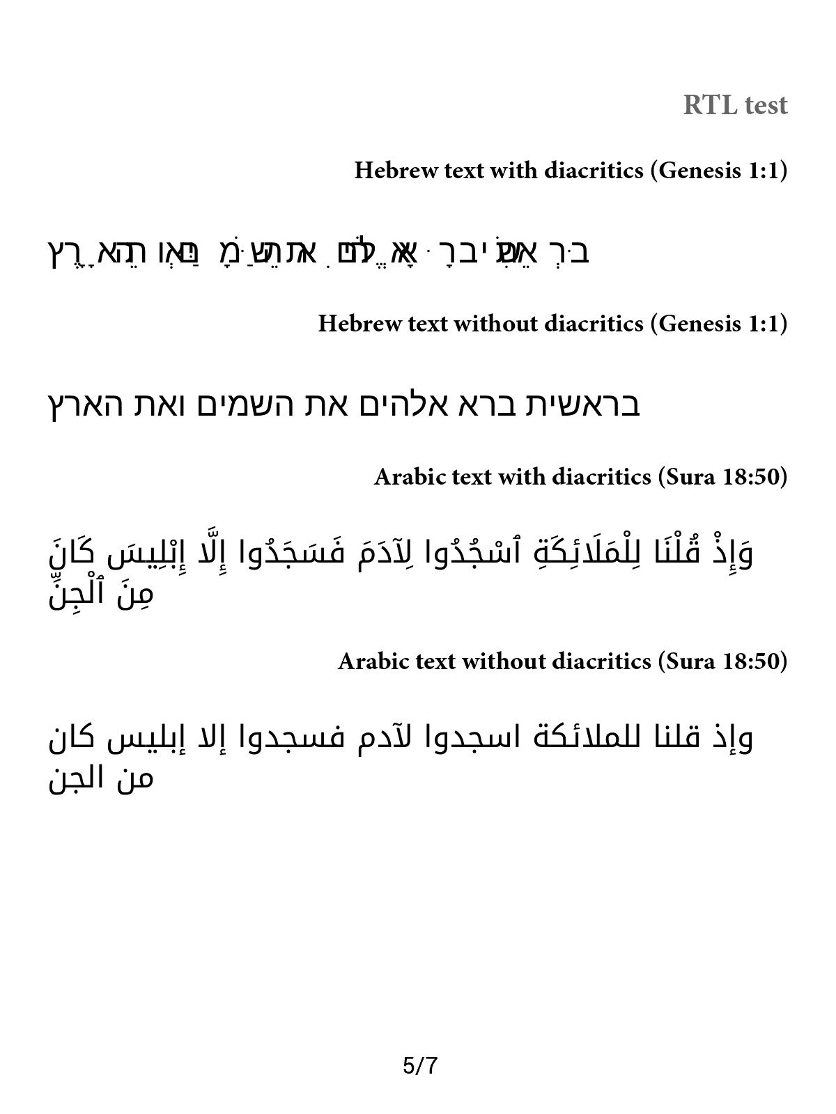

I'd appreciate it if someone with a relatively new Pocketbook e-reader could test this file and take a screenshot of the last page.
It should look like this:

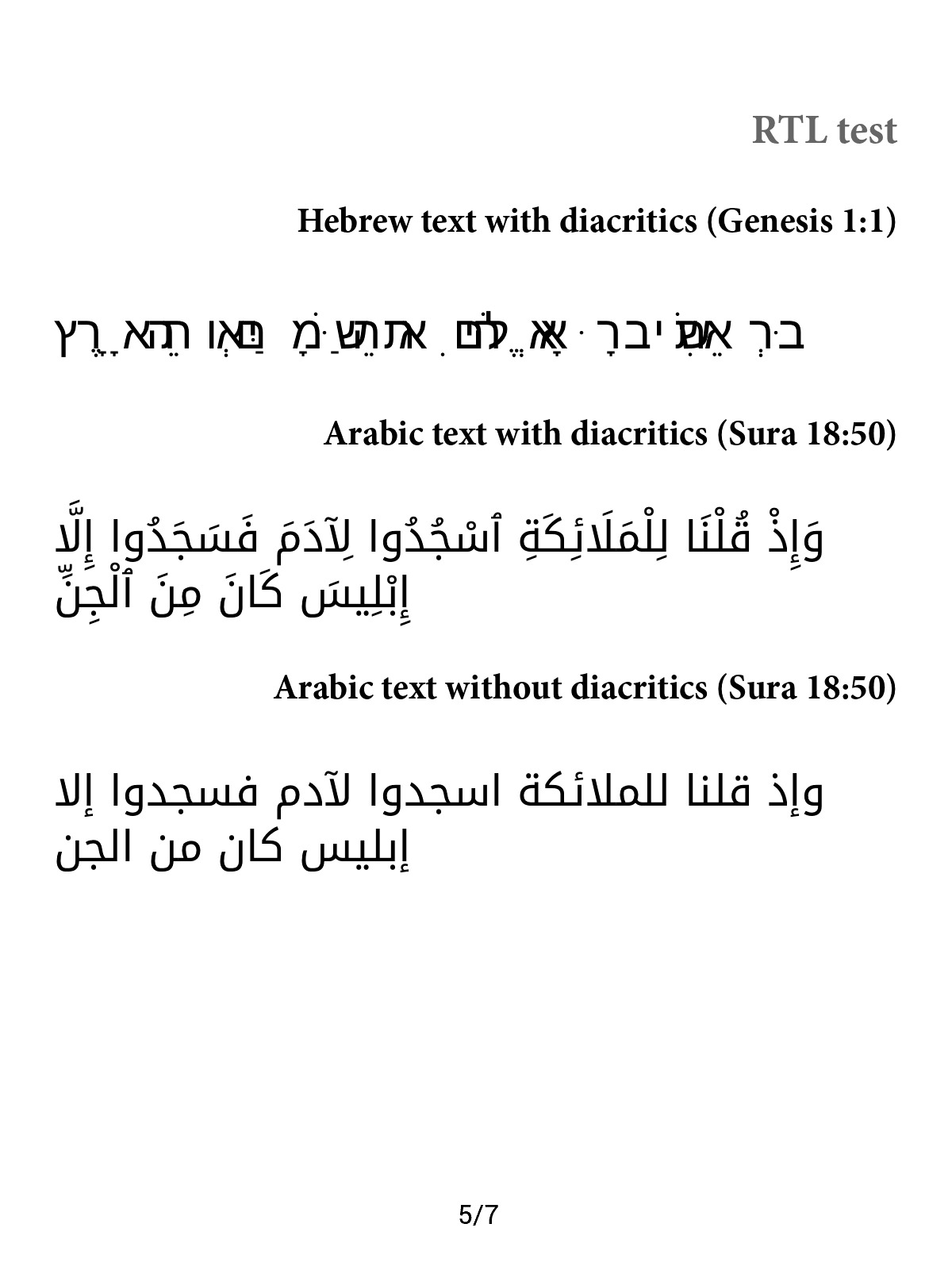

I've attached a screenshot from my Inkpad (firmware 5.4.98). The Hebrew looks wrong, but the Arabic may be okay.
My Touch Lux 623 got both horribly wrong, as if it didn't have the correct fonts for either, but it's a few years old now. What did you mean by non-PB models?
Thanks for testing the file. The Arabic text indeed looks perfect, but the Hebrew text doesn't, which is rather strange, because e-readers that support one RTL language well usually also support all other RTL languages.

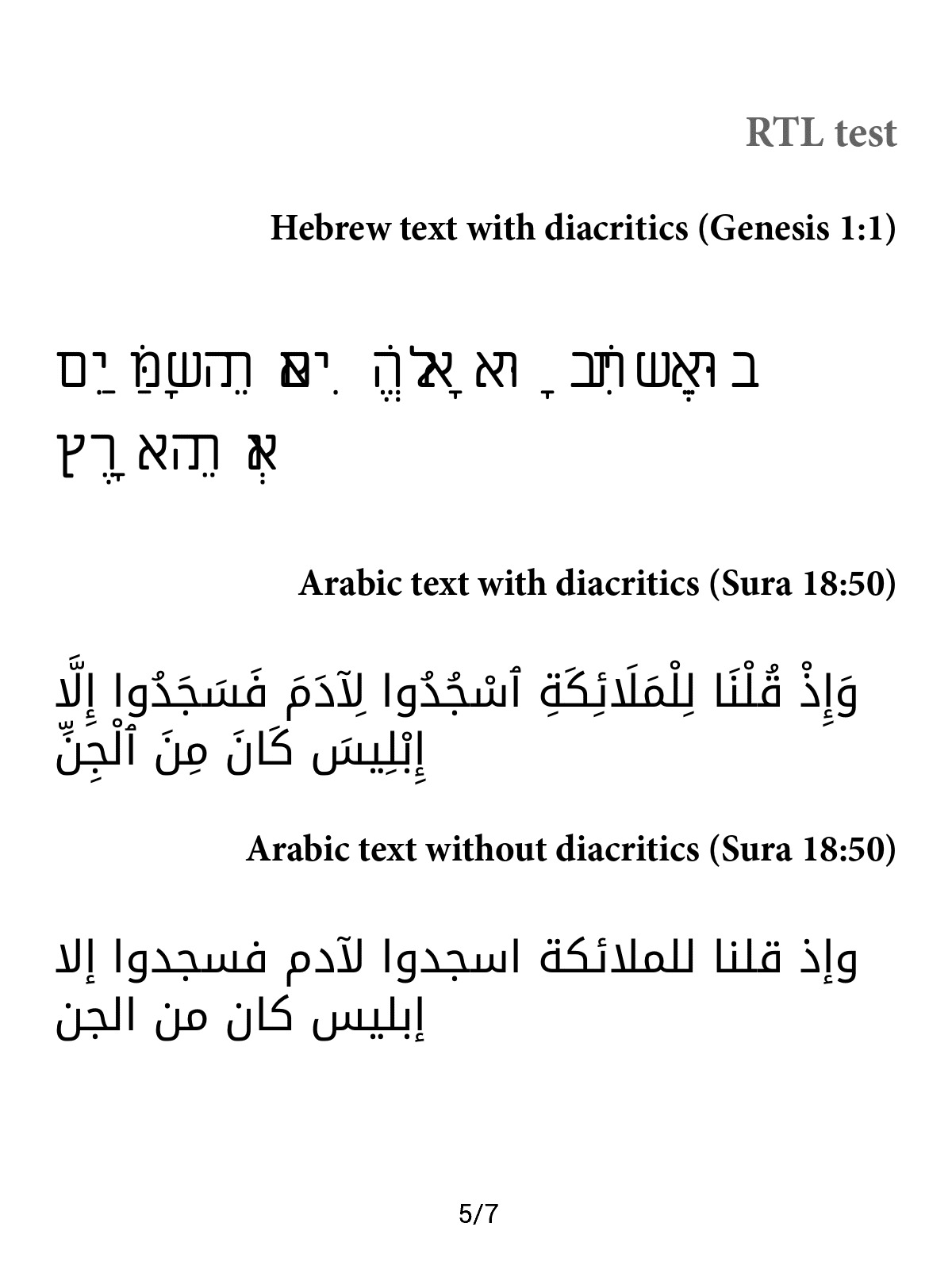

Okay, here's the new screenshot. The Hebrew still looks wrong. It seems that the diacritic marks are showing up in the wrong places.
Edit: It's more than the diacritic marks that are kerned improperly. Each time I change the font size, the characters are spaced differently relative to each other.

Here are the results with the latest version of the document. Again, there are problems with the Hebrew kerning. I tried some of the built-in fonts, and those also showed similar problems. The Arabic seemed to look fine with the built-in fonts, as well as the embedded one. Strange.

Thanks again for your help. You've confirmed that the Inkpad supports Arabic including text with diacritics and Hebrew without diacritics. (It doesn't seem to right-align the paragraphs, though, but IMHO this is a minor issue.)

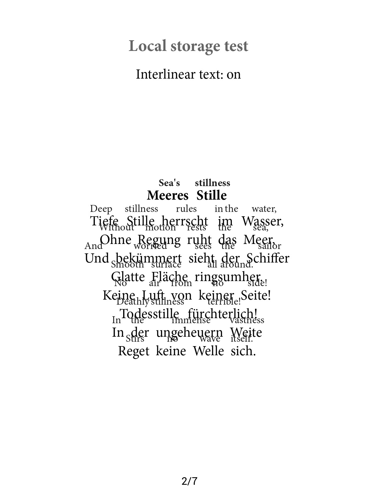

Here's a screenshot from the Touch Lux 2 (Firmware R626.5.7.515). The Arabic looks good to my (untrained) eye, using CoolReader and Google's "Literata" font. I override all custom fonts by default, by the way.
Installing a Hebrew font might even work, but there's apparently none at the moment.

Thanks for testing my file. Unfortunately, the Arabic text is rendered LTR and the Arabic letters are isolated (for example, ا ن ل ق vs. قلنا).

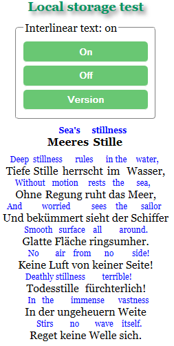

In that case, can you please test the first page with the green buttons. If you have the latest RMSDK version with JavaScript support, it should display the version number.

I had to look at the document with Calibre ebook-viewer to find out what you meant. The green buttons don't even show up in AdobeViewer on the device. I've attached a screen shot below.
I'm not sure which version of RMSDK is used to build the app on the device. The license page says the copyright is 1995-2009, but that sounds too old even for PocketBook. I suspect that they just haven't updated the description since they first wrote it.
Perhaps someone with a more recently produced device can test and see if anything is different?
This means that the Inkpad AdobeViewer version is based on RMSDK 10. Hopefully, PocketBook will add an updated AdobeViewer version in a firmware update.
