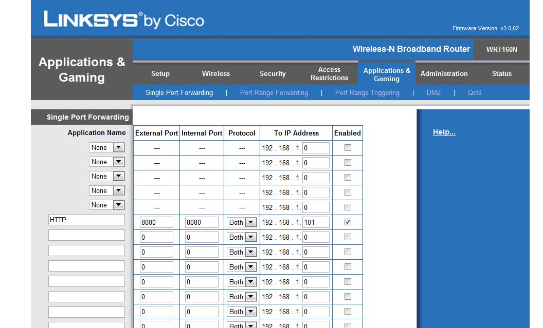

Thanks for replying. I couldn't see any free service at dyndns.org. But is the router IP addr the external IP? I can see that on my router setup, and also when I run speedtest.net, the same IP addr shows.
On my router, I've attached a jpg of what I did for the port forwarding, where the "To IP addr" is my computer on our local network where Calibre is loaded. Don't know if it's right, but could you comment?

Originally Posted by Ginnia View Post
itimpi---
That is one part, very important (that is port forwarding)
To connect from the outside you need to know the Outside IP (on the WAN side) or configure DYNDNS (some other screen)

A couple of other tips, if you are port forwarding, you need to fix the address of the PC - If the router supports it, I prefer to fix using the mac (hardware) address to IP mapping in the router, rather than forcing a fixed address in the PC TCP/IP properties. Similarly, if the router supports a dynamic DNS (that you can get free service from), then it saves having the client software runninng on the PC.
