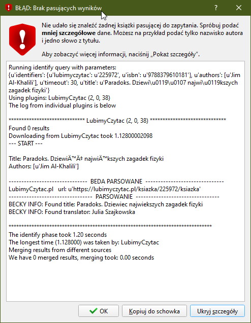

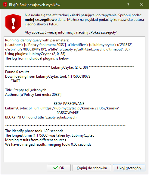

Old 04-01-2020, 05:45 PM   #34
lighta
lighta began at the beginning.
Join Date: Apr 2020
Device: Kindle Paperwhite
Extension stopped working
Downloading metadata from lubimyczytac stopped working.
For every book calibre shows there is 0 results. I've checked - there is information about them in lubimyczytac and some time ago I fetch this data.
I tried for 150 ebooks - 0 results.
Calibre version: 4.13 (but I downloaded 2 other portable versions for example 4.10 and problem is the same)
Name:	2020-04-01 23_40_04-BŁĄD_ Brak pasujących wyników.png
ID:	178061   Click image for larger version
Name:	2020-04-01 23_40_46-BŁĄD_ Brak pasujących wyników.png
lighta is offline   Reply With Quote
Old 04-02-2020, 02:17 AM   #35
BeckyEbook
BeckyEbook's Avatar
Posts: 898
Karma: 3501166
Join Date: Jan 2017
Location: Poland
I confirm the problem. I'll look at this.
EDIT: Fixed.
BeckyEbook is offline   Reply With Quote
