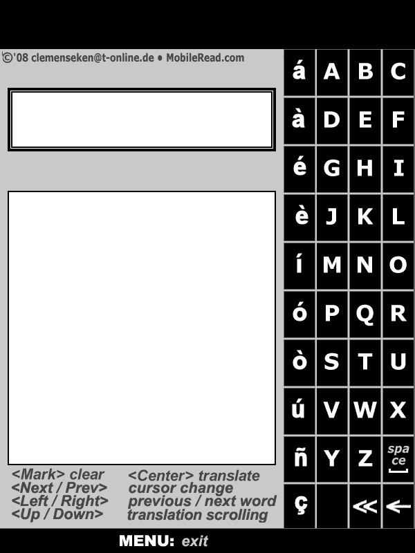

It is difficult to adapt the dictionary with additional characters to use it in Spanish and Catalan?
see the exemple of skin

surquizu
It's possible to add limited number of letters, but then comes "which letters" problem. Generic solution is much more complicated.
kartu is offline   Reply With Quote

Originally Posted by kartu View Post
surquizu
I just need the letters of the example. Can you explain what variables to change? I want to try

surquizu
You'd have to adapt functions:
target.moveCursor (line 153)
target.arrowKey (line 168)
To support additional column (basically replace 2 with 3).
Then change keyMap (it's a variable, line 21, easily understandable format)

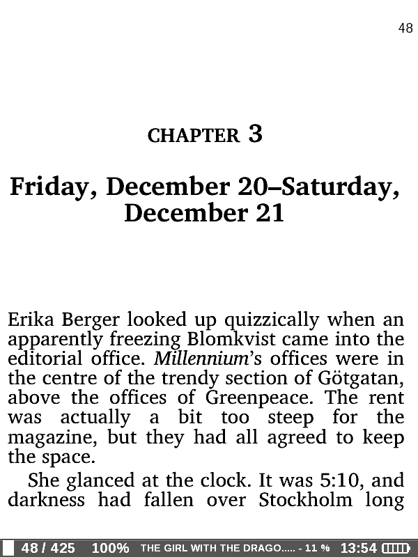

Thank you so much for incorporating the Dictionary function and giving me back my "British dates". I also like m-land's tabbed dictionary modification.
I have an unrelated question. Is it feasible for PRS+ to add extra info into the Status bar, alongside page numbers.
e.g. current chapter, book title would be nice.

jackie_w
I am not sure that "current chapter" info is available, book title, however is.
But the question is, where could one fit all that info? And isn't it simpler to do it when preparing the book (ok EPUB doesn't have page header/footer, but LRF does)

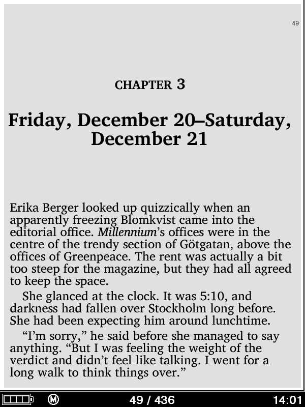

I am not sure that "current chapter" info is available, book title, however is ... And isn't it simpler to do it when preparing the book (ok EPUB doesn't have page header/footer, but LRF does)
Thanks for responding. One of the reasons I raised the query is that I liked the LRF header/footer. Because it had become obvious that LRF had no real future in Calibre, I forced myself to only use EPUB because I don't want to be fruitlessly moaning that my converted LRFs "aren't quite right". Now I am very happy with the combination of EPUB/PRS+ and can do all the formatting I've ever wanted (except right justification).
I recently bought a second ereader (PocketBook 360) because I wanted to try a more portable 5" model with bells and whistles. I have been amazed at how much customising an amateur, like me, can do. Status bar is just one small example (although displayed info varies depending which viewer you use, ADE or fbreader).
Just for info I have attached 2 screenshots showing the same EPUB in ADE on the 2 different readers. I have deliberately picked a book with a too-long title. Do you think the status bar on the 5" reader is too "busy"? An even smaller font could be used if that was better.
I don't want to push this too hard if you don't fancy it. I just thought it might be nice. By the way, I still love my PRS505 so keep up the excellent development work.
