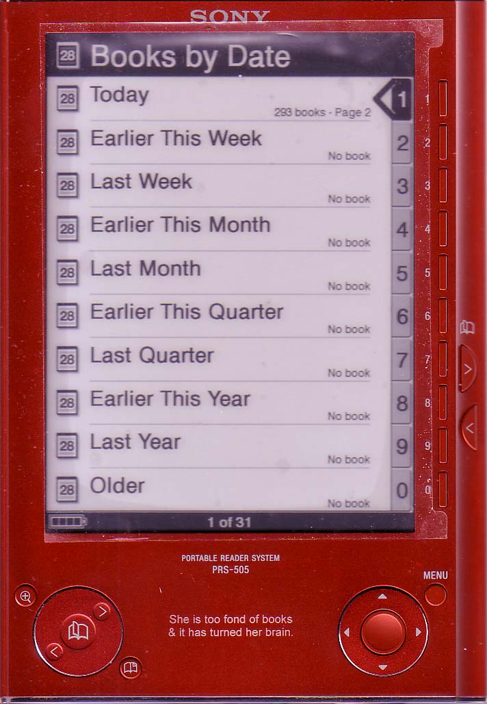

Since I got my Reader back from Sony after a broken substrate, the "sort by date" on the Reader doesn't work.
Well, it sort-of works. The ebooks are all there, in reverse-added order. But they're all showing up under *today*, regardless of the actual date. (It lists the date. But they're all listed under the 1st tab number.) See attached image.
Anyone know what causes this, or how to fix it? If it turns out not to be fixable, I won't worry; it's a nuisance, but not a major hassle.
If you put all the books on your device "today" then it sounds right to me.

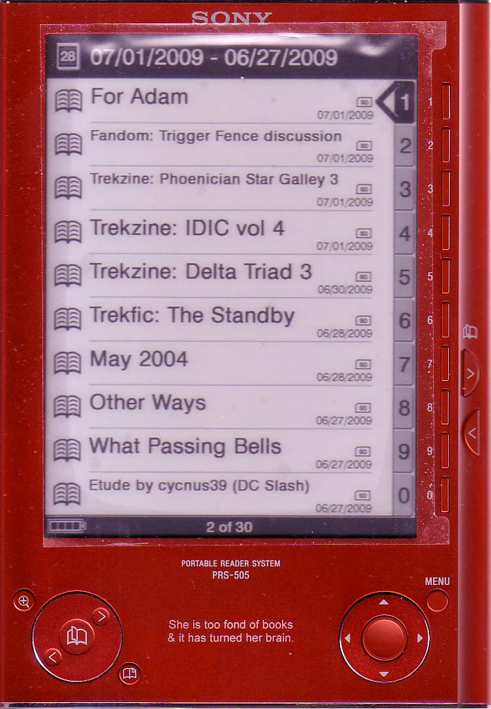

Nope; got stuff going back months. It's just not sorting them into the non-today date settings.
Ermm... ok.. I read "got back" as "got back today" so I assumed they all had todays date on em.
Have you tried a hard reboot of the reader?
