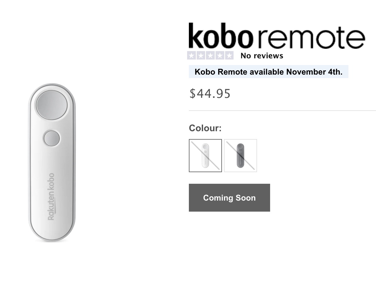

Mystery revealed, it's a remote page turner.
(Before foreigners faint at the price, these are dollarydoos)
https://au.kobobooks.com/products/kobo-remote
Name:	Screenshot 2025-10-14 at 5.32.08 pm.jpg

Yes, the (same) remotes will be available for the Tolino e-readers, too („tolino flip“).
By the way, KOReader doesn't support any bluetooth remotes for Kobo devices, does it?
45 dollaridoos!?! That's some Apple-level accessory prices.
