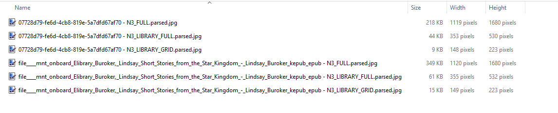

Hello. I have used the plugin to change the covers of books on a Kobo Libra Colour, but although the image dimensions are correct in the Calibre library, when I hover the mouse cursor over the book covers on the device, the resolution displayed is much lower. For example, a cover that I have at 780x1200 pixels is approximately 500x800 in the book. I have tried deleting the book covers from the Kobo and sending the covers using the plugin, but there is no way to maintain the resolution. Any suggestions? Thank you.

You might want to remember that your Kobo stores the covers with 3 different resolutions plus the cover image stored in the ebook. Since your Libra Colour does not have a mouse, I'm assuming that you are looking at the book covers using calibre.
If I look at the .kobo-images directory on my KLC, each book has 3 images which for me show as shown in the image below (I renamed the files to *.jpg). These files are generated from the cover image during the import process. When I look at the details in device view of a book, I see the resolution corresponding to the N3_LIBRARY_FULL.parsed image.

Ah, thank you very much, DNSB. I see that I have those files in folders (with numbers instead of book titles) and that by adding the .jpg extension I can check what you say, and indeed everything seems to be correct. I did check the resolution in Calibre, in the Device section... and I don't know why it's reduced there, but I'm not worried about it anymore. Thanks again.

Calibre shows the cover from inside the ebook. Changing the cover on the device doesn't affect what's in the book.

I may be mistaken, but if I used the plugin to delete the book covers from the device and then again to send the covers from my library to the books on the device... shouldn't the covers inside the books have been changed as well as those in the directories referenced by DNSB? All the books I put on the Kobo had covers measuring at least 800 x 1200 pixels, and in Calibre's preview of the books on the device, those covers are displayed as just over 300 x 500; so I assumed that it was showing one of the files in that directories and not the covers inside the books. Sorry if I'm mixing things up, but I'm not really sure how it works, to be honest.

No. The cover inside the book doesn't change when you change the cover in the calibre library or send a cover to the device using kobo utilities. If you change the cover in calibre (edit metadata etc) and want the cover to change in the book then you must use polish, embed metadata, modify epub plugin, the calibre editor, or perhaps other methods.
For example, the following sequence does not change the cover in the book.
  • Add the book to calibre.
  • Send the book to the device.
  • Update the cover in calibre.
  • Send the new cover using kobo utilities.
The cover inside the book is normally updated to the cover in calibre's library when you send the book to the device. If you want the cover inside the book on the device to change then you must resend the book after updating the cover in the calibre library.
