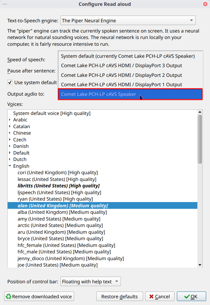

Now in Calibre’s ebook viewer, when selecting »Read Aloud«, it immediately started downloading a voice called libritts (United States) [High Quality]. I can also download other Piper voices.

Where are these stored? I don’t really want to download & store all voices I use twice.

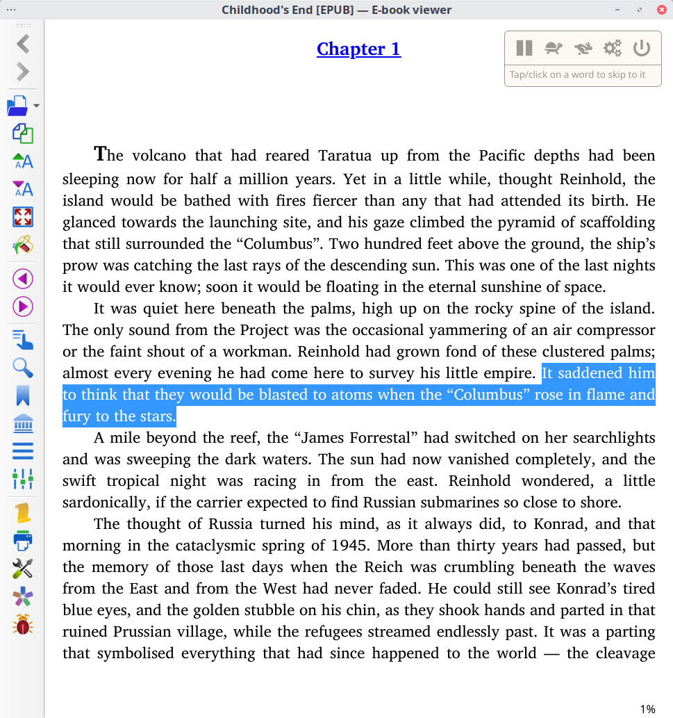

When using the suggested The Piper Neural Engine, a reading progress is shown in the book (blue highlight) but I get no sound, whatever output device I select.
Name:	Childhood's End [EPUB] — E-book viewer_001.png

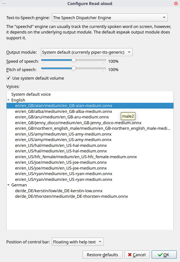

When switching to my already-installed The Speech Dispatcher Engine, I get a list of my installed voices, can select one, and it reads the book text in the selected voice—but without any indication of position, and no page turning.

If you want reading progress you have to use the piper engine. speech dispatcher doesnt have any. It's output goes via Qt Multimedia which in turn goes via ffmpeg which goes via pulse audio (or pipewire) which goes via the linux kernel to your hardware. something in that chain is broken in your system. Fix it and you will be fine.

Yeah, I know, unfortunately that can’t work with SPD as it is.
Thanks for the short insight to the pipeline. I’m using Pipewire, so I installed qpwgraph to check what happens, and surely enough, it had selected an output called "System default (currently Comet Lake PCH-LP cAVS Speaker)" but in reality connected to "Comet Lake PCH-LP cAVS HDMI / DisplayPort 3 Output" (as shown by qpwgraph).
Setting it to "Comet Lake PCH-LP cAVS Speaker" made it work.
Name:	Configure Read aloud_004.png
It’s unfortunate I now have to waste lots of space by having two sets of Piper and the TTS voices, but anyhow, thanks for making it easy for the rest of us, and chunking it so we can see nice highlighted reading progress. The direct voice download is also a nice feature for newbies.
