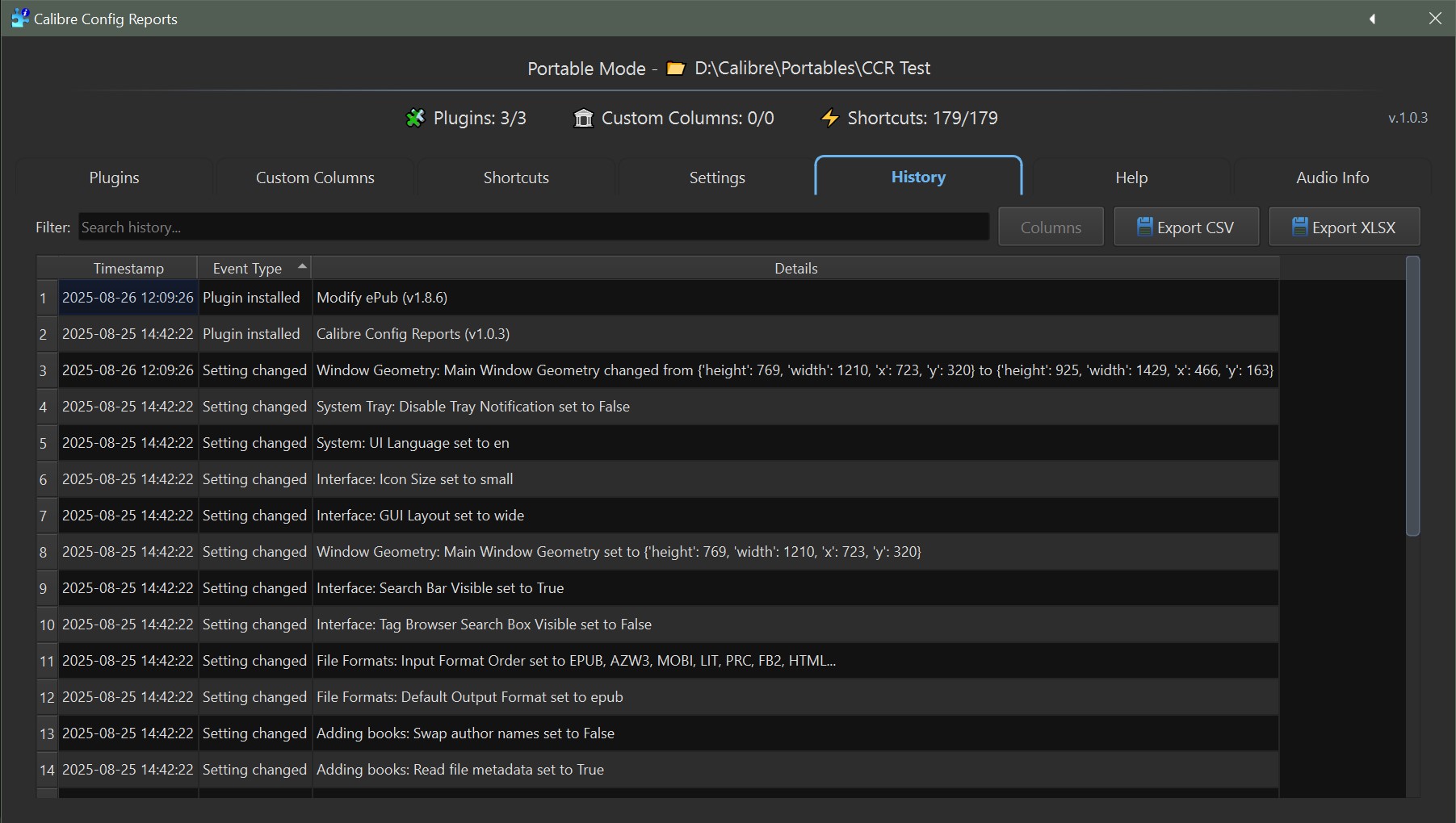

The Count Pages and Modify EPUB plugins don't have default shortcuts and they report as None when they're installed, viz:
Name:	Screenshot 2025-08-26 121629.jpg
I installed Count Pages and Modify Epub together, i.e. no restart after CP, History only shows the installation of Modify Epub.
Name:	Screenshot 2025-08-26 121723.jpg
