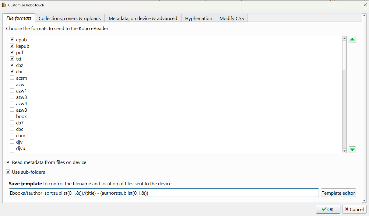

What @PeterT said. The reason for looking at those files is to allow you to see what your configuration was. As for automatic metadata management? It has always worked for me. I've attached a set of screenshots of my setup. The User Kobo viewer for EPUB books is checked to convert to .kepub.epub on the fly.
