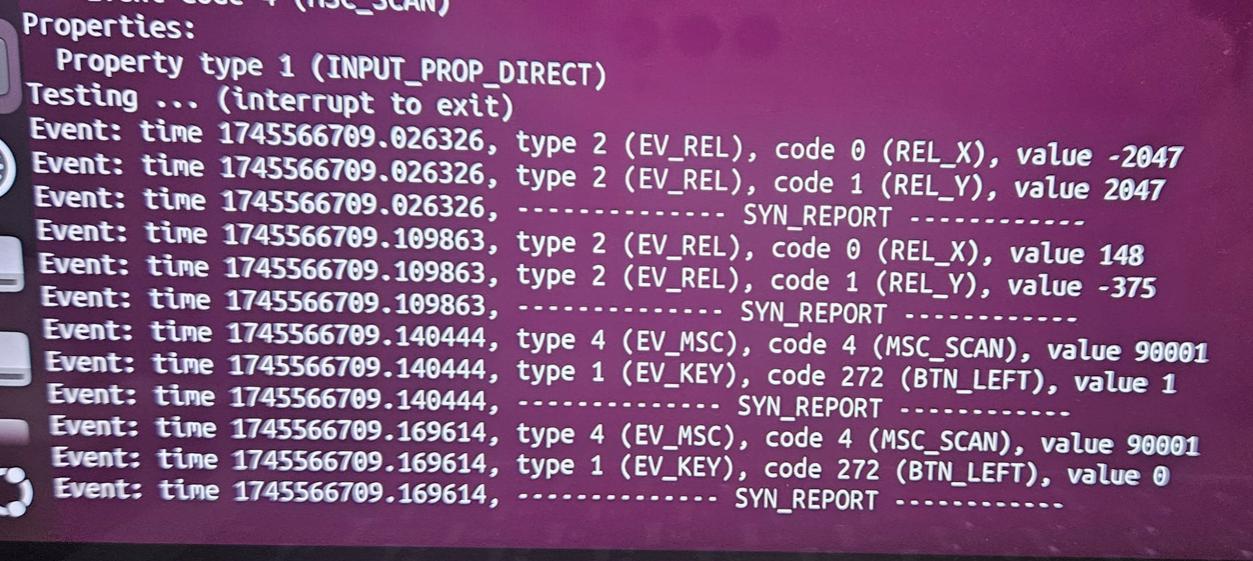

I also have a device whose Bluetooth name is Beauty-R1, but the model number is DY10 and it has 9 buttons in total. I've attached what it looks like to this comment.
The arrow buttons work as a mouse on my Android phone (there's a icon and it can swipe).
My Kobo Libra 2 can connect to it via Bluetooth, but it doesn't appear in my Kobo's /dev/input folder.
Can anyone give any advice or suggestions on things to try? Thank you!

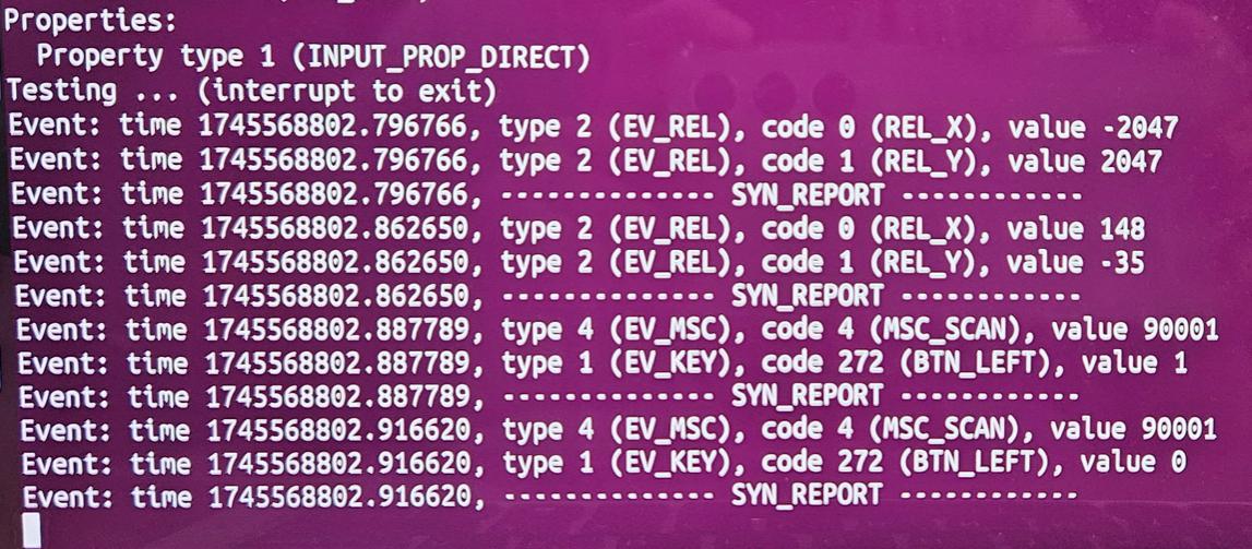

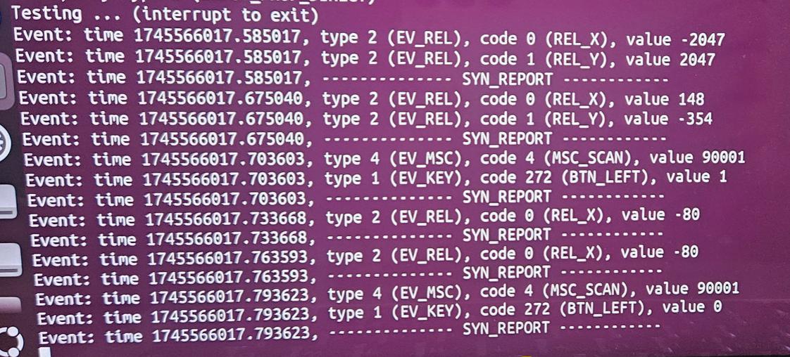

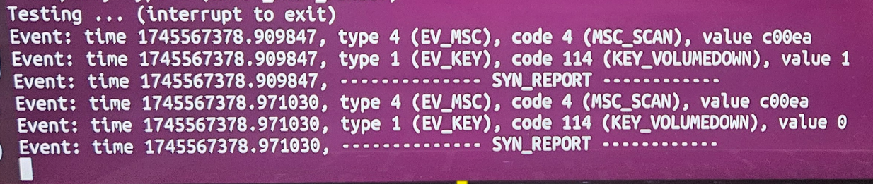

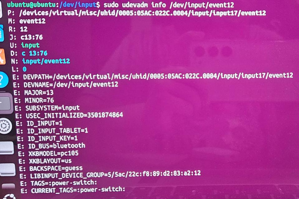

# Evtest output
I've uploaded some evtest output for the various buttons, sorry it's an image as I had to boot Ubuntu from USB in order for the Bluetooth Beauty-R1 to be detected (VM didn't work!)
I also uploaded an image of the udevadm info of the device.
