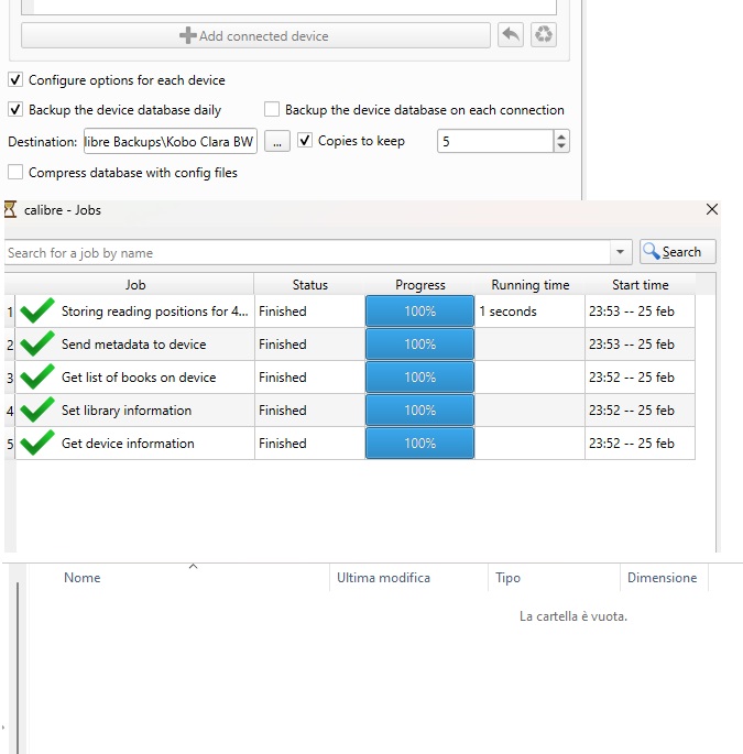

Hello, is there an issue with the automatic database backup?
I can't figure out why it doesn't trigger, neither as a "daily backup" nor "on each connection".
Everything appears to be set up correctly.
You may be on to something.
My last BU (Zip) is dated the 20th. I am pretty sure I have connected more recent
Calibre 7.26.100 W10
Old 02-25-2025, 10:54 AM   #81
ownedbycats
Custom User Title
ownedbycats's Avatar
Posts: 11,642
Karma: 81419259
Join Date: Oct 2018
Looks fine to me. "Copies to keep" enabled? I don't have it on.
I'm still getting automatic daily backups, but I've held off on updates. Reporting just in case it helps to narrow down the timing.
Calibre 7.24
Kobo Utilities 2.17.2
fogice is offline   Reply With Quote

DB backup is working here on Clara BW and Clara 2E.
7.26
2.18.2

Tried now, nothing.
No backup generated.
I'm on the last version of Calibre and the plugin.
Am i missing some setting?

The only setting different to mine is i have copies to keep unchecked.
Tried now, nothing.
You need to enable the setting "Backup the device database on each connection".
Probably overrides the setting "Backup the device database daily" so you can uncheck that one.
