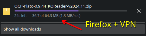

Originally Posted by shuvashish76 View Post
@NiLuJe Is it possible to host the files at GitHub or somewhere else? The storage.gra.cloud.ovh.net links taking forever to download. Download speed is too slow (15-30kbps) when downloading files from this domain.
As you can see the download speed is slow again. Not sure if it's due to my geo location?

It's definitely related to geo-location or server issue. Works fine on Tor browser or when using VPN but without them it's taking forever to download.

@shuvashish76 Yep. I just downloaded with 3.5MB/s
Still think it's a bit odd that you're complaining about free code download that you'll have to wait half an hour for. Why don't ya grap a coffee?
