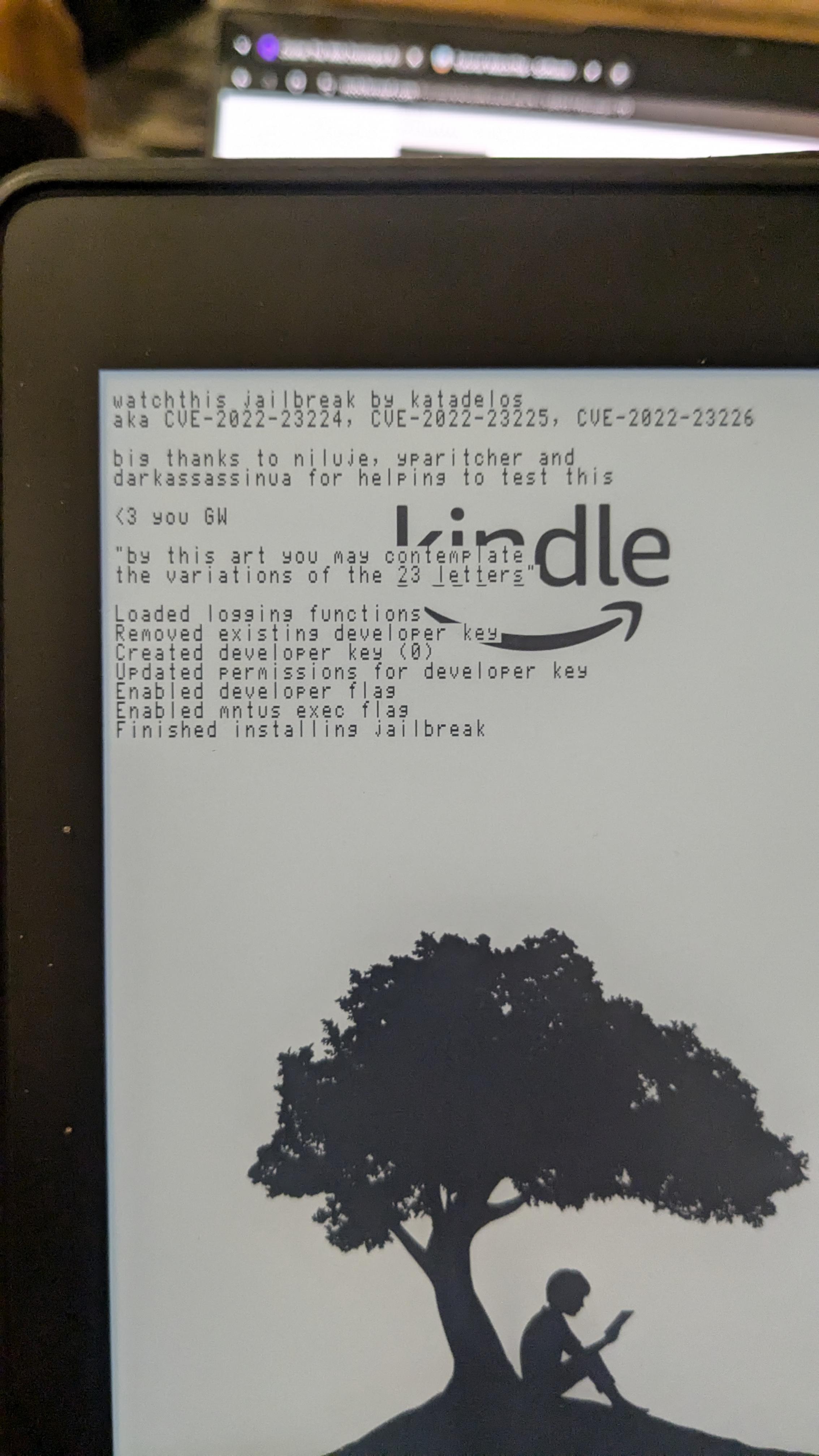

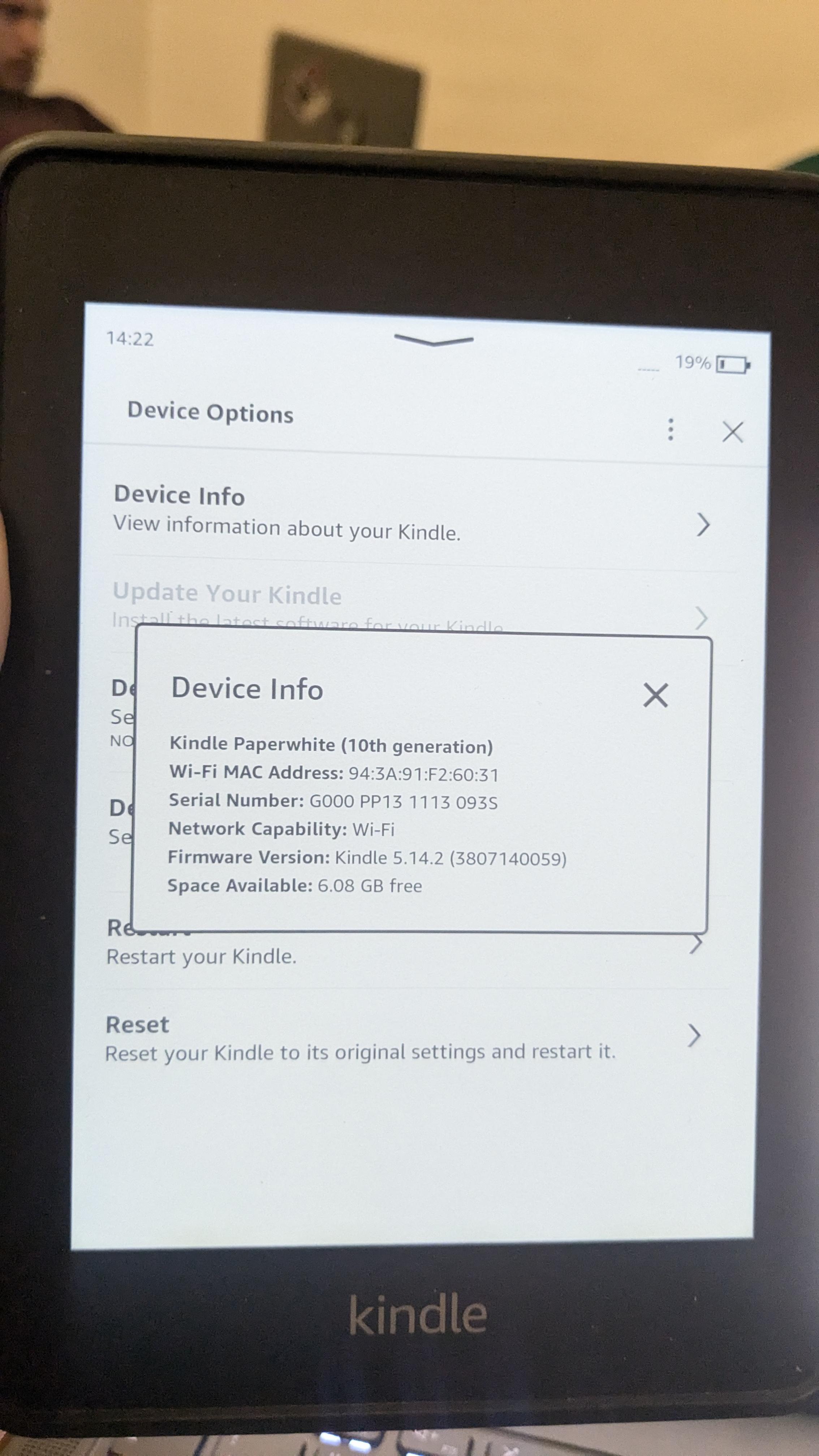

Old 11-28-2024, 09:19 AM   #1043
userresu
userresu began at the beginning.
Posts: 10
Join Date: May 2022
Device: paperwhite 10
ID:	212253Thanks for the quick reply.
While rebooting, there is running some of the jailbreak script in the corner, stating: "finished installing jailbreak."
But afterwards there is still the issue with the greyes out update field.

Old 11-28-2024, 11:26 AM   #1044
userresu
Posts: 10
Join Date: May 2022
nevermind, everything seems to work as described Thanks once again
