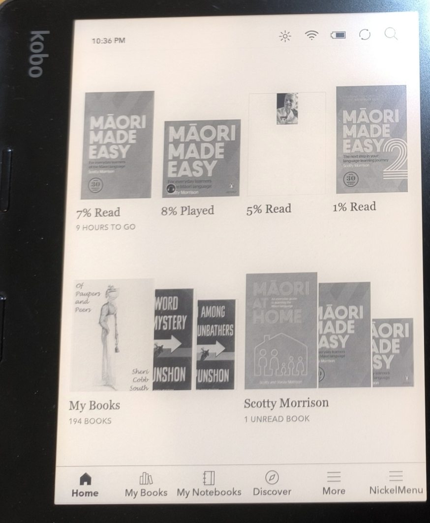

I drew the conclusion about my patches working after running the .bat file, as usually there's an error when something doesn't work.
Yes, that what puzzled me - I'm used to that kind od error, it's the first time I can recall a patch not triggering a fail but at the same not actually doing anything.
EDIT:
I just ran the same set of patches on my wife's Libra H2O (with the appropriate firmware of course). Same result. No failure or error, no change in display of the 3rd row

This is really odd. Here is the relevant line from my nickel.yaml
remove footer (row3) and increase cover size on new home screen:
  - Enabled: yes
and here is the relevant line from the log generated by kobopatch.bat
"Remove footer (row3) and increase cover size on new home screen": false,
Other patches I've enabled in the various yaml files all show "true", but this one, it seems ONLY one, does not.
I just ran kobopatch.bat again and this time copied the text about directl, not from the log file.
This is what says on the relevant line:
DISABLE `Remove footer (row3) and increase cover size on new home screen`
Other patches that I have enabled have "APPLY" before them, as
  APPLY `Unify font sizes`
  - Enabled: yes
I don't have this in my log files either for Sage or Libra 2. Both show "true".
Maybe a conflicting patch was enabled?
That is what I assumed. But searching the log turned zero hits for "confl" as a string and in the past when I have enabled two conflicting patches, that tgz was not generated at all.

I took another look at the output from kobopatch (not the log), and saw this:
Loading configuration from kobopatch.yaml
When I checked THATyaml , sure enough the non-applied patches were disabled. So I edited IT, and voilà - a reminder of the dizzy heights I can occasionally scale when both neurons fire at once.
